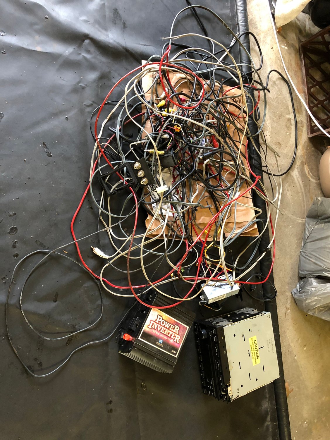

I pulled the dash panel off today while I was prepping to do an Android install. I couldn’t find any source of the noise, but while it was off I stuffed a couple of microfiber cloths in between the duct area for the defrost. At this point it seems to be about 90% resolved. Still getting some noise but it’s drastically better.
I’m not sure if the stuffing solved it or not. While I was pulling the stereo I found tons of old wiring from what must have been an old DVD player install. Included in that wiring I found an FM modulator and noise suppressor just loosely wired in back there and swinging around.
