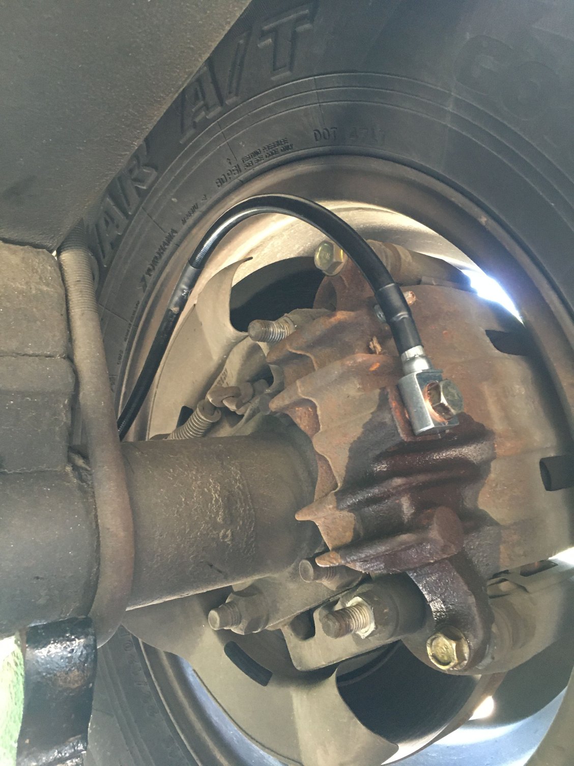

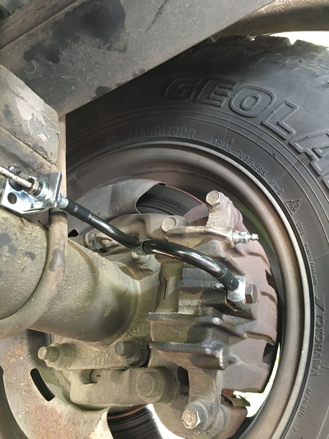

Passenger side:
Drivers side:
The drivers side line has to come up from behind the axle so needs to be longer. The Passenger rear caliper is used on both sides in these early super-duties.
