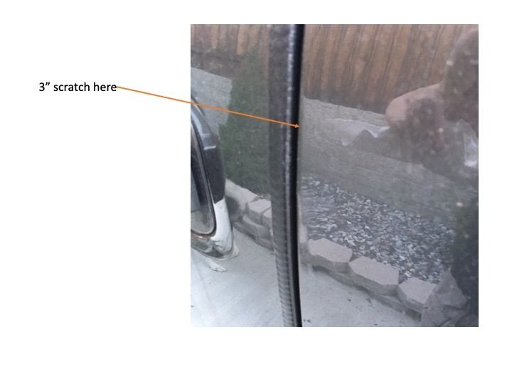

I gouged the crap out of my drivers side passenger door getting my fat *** and CCW in the truck one day. $800 quote from the body guy so...hours of youtube and several products from Amazon later, I learned this:
- Duplicolor and the Ford touch up are almost identical and both were a good match for my magnetic paint. I like the Duplicolor better.
- Prep is critical. You have to take the hard edges off the scratch before you fill. I used 1000 grit wet dry to get it "U" shaped with flat edges using a thin sanding block.
- Forget the brush in the kit. Buy a small artists brush and cut off most of the bristles and use that to add several thin layers of color.
- When the paint is close to level, wet sand to 2000k to make it flat again. Use a little block, not your finger, about 1/4" wide
- Add the clear with a fat, quality art brush, a little wider than the scratch. For me this changed the color of the fill paint dramatically. It went from being "close" to almost exact.
- Wet sand again with 2K or better LIGHTLY! Then polish, then wax.
It took me about 10 tries to get to where I wasn't ashamed of it but the prep is the key if you want it to look normal. I can still find mine if I look for it but it also didn't cost me $800. For the OP, the edges of the scratch and the flatness of your repair will change the color. The depth of the clear has a lot to do with the metallic color blending in. I found that if the clear wasn't thick enough, it didn't blend.
