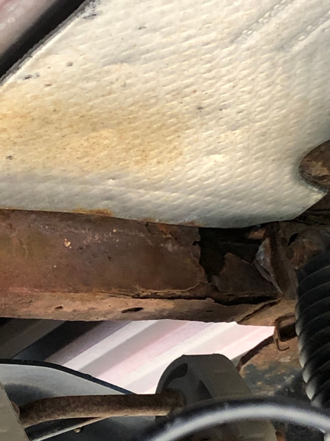

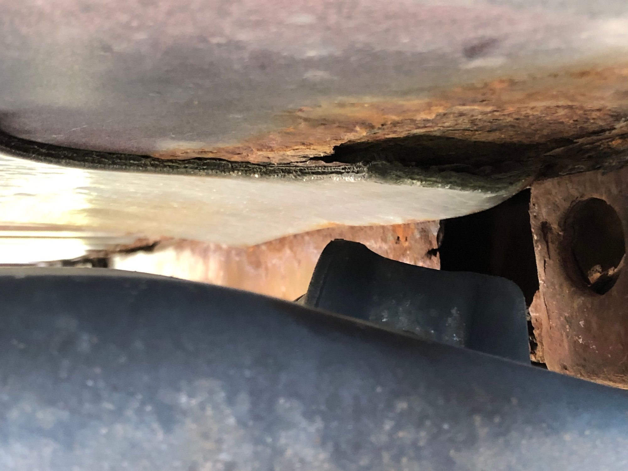

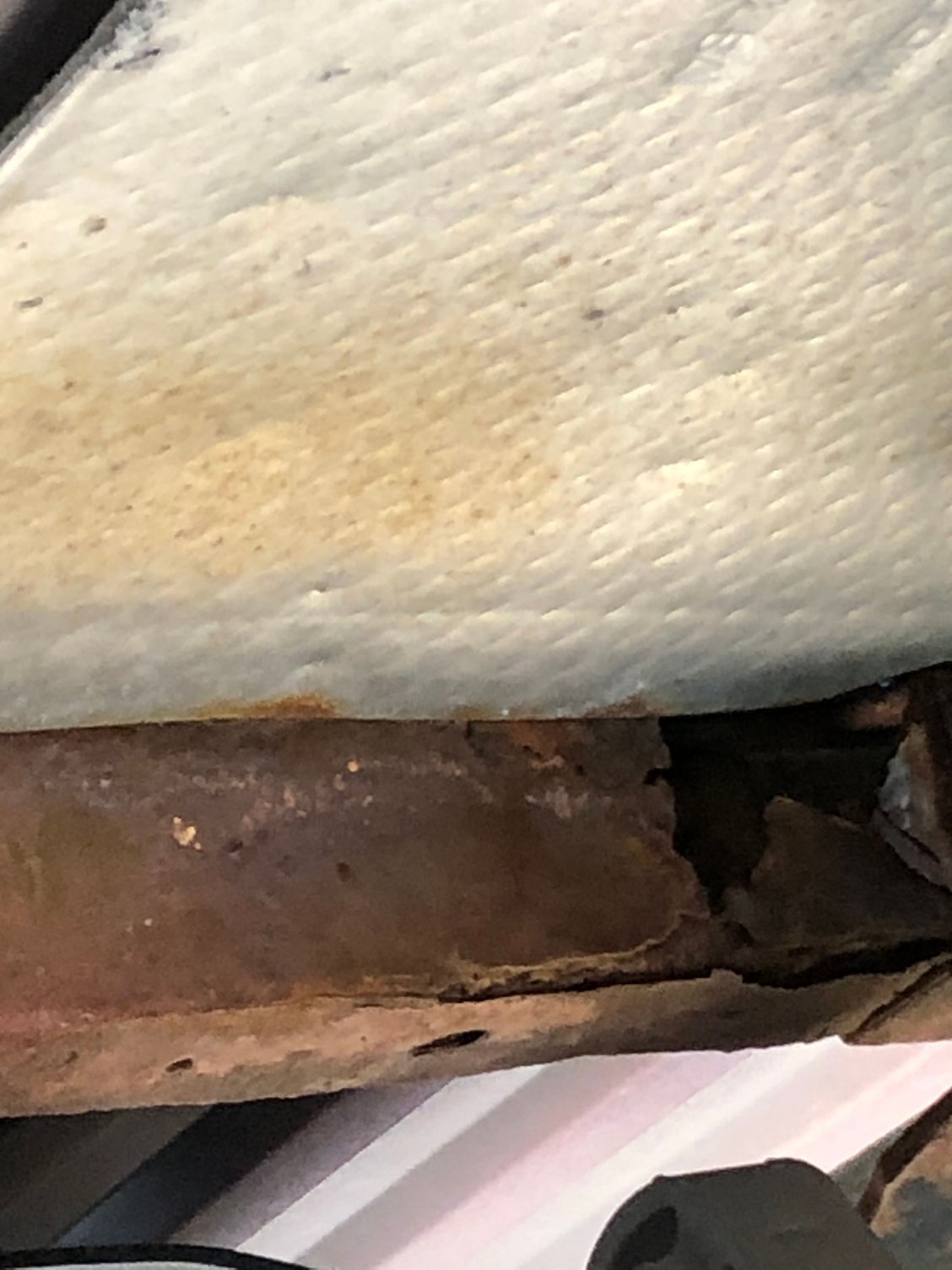

I have a 2011 ford f250 crew cab owned it since new, have noticed rust on the cross rails of the underbody of the bed .Is there any thing that can be done to fix this or like some kind of filler that can be put in there that gets hard. the truck bed looks great on the outside and lower side. I'm not that knowledgeable about this area so any expert help would be great, THANKS

In short, it's either cut out all the rusted structure and weld in new or IMHO what may be much more cost effective is to purchase a use rear clip and weld it in.

For repair of that typically the bed is removed, rust infected crossmember(s) removed, new ones welded back in..

Body needs to come off. Remove the rusted parts and replace them. Only way to ensure you get it right. If more then one cross member, do them one at a time.

Seeing where that rust is, 100% chance that the floor above that heat shield is about to hole. Been there, Done that on a 2012. I have the rebuild thread in the up to 16 Superduty section. Took 4 weeks and a LOT of work but had a nearly new bed that was rust free and well protected when done.
