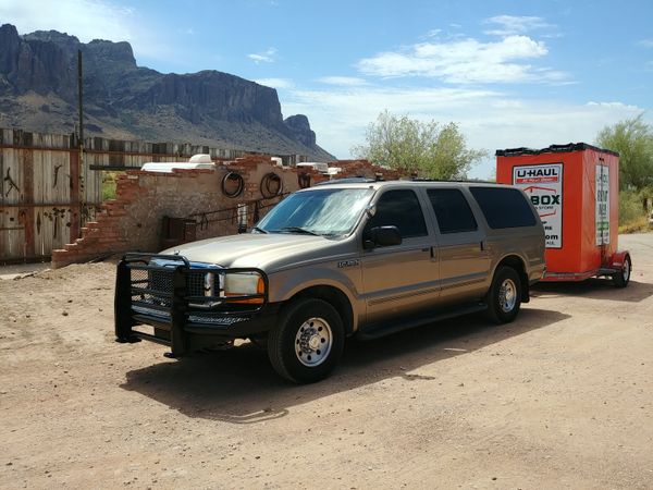

I have a 2000 Excursion Ex-FBI Field Vehicle, still has the search lights on it, and a front bumper that looks intended for ramming things.
For Reference, this is a 2WD, not a 4x4.
I am looking at modernizing it a lot, planning to send it off to get a 2016 facelift to the front end, keeping the interior as is because its somehow damn near immaculate, this thing must have been used by high ranking because its more spotless than i can imagine unless its been redone fully at some point.
