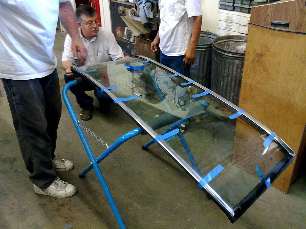

Old Aug 22, 2020 | 08:49 PM
lafermedavid's Avatar
lafermedavid
Joined: Nov 2010
Posts: 3,172
Likes: 101
From: darlington
This pic helped me when I was installing mine (back in the day)

I'd like to see an assembly line picture from back in the day of putting that stainless on. Read a short article once written by an assembly line worker at Ford, he installed and adjusted the fenders on Falcons at a rate of 1 every 60 seconds all day long.

Lil bit of redneck ingenuity and a lot of tape to peel once I get it on the glass but it’s going

nice job,,,,its not easy,,,,,,I have a friend took his Bump to have new glass put in,,,,came back installed without stainless,,,he was very pissed,,,,also good that's its not winter
