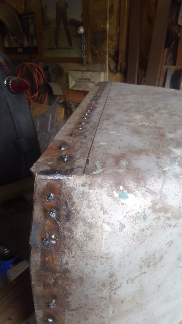

Got a start on the rear wheel wells. Using uni body wheel wells that I cut off another truck. Had to drill out the spot welds and take off old metal beds strips. Weld the holes shut and trim about 2 inches off of the well. Make a new inner well panel and weld it together. As far as I got. I used what I have and will make it work. The new sheet metal will be on the out side facing the body. Right or wrong thats what I am doing. Will do more pics as I go along.

Was the unibody beyond salvation? I never liked them but saw on the big auto auction a restored unibody was high sales record the day I watched.

I have a 63 uni 250. A guy sold me the 62 uni truck. Only 2 doors , the bed and cab. They took sheet metal and covered the rust and bad spots and filled it in with filler and pitch over the top. Did not waste alot. At least I got some use out of it.
