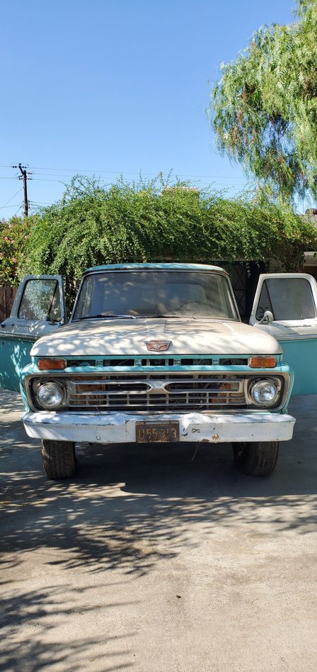

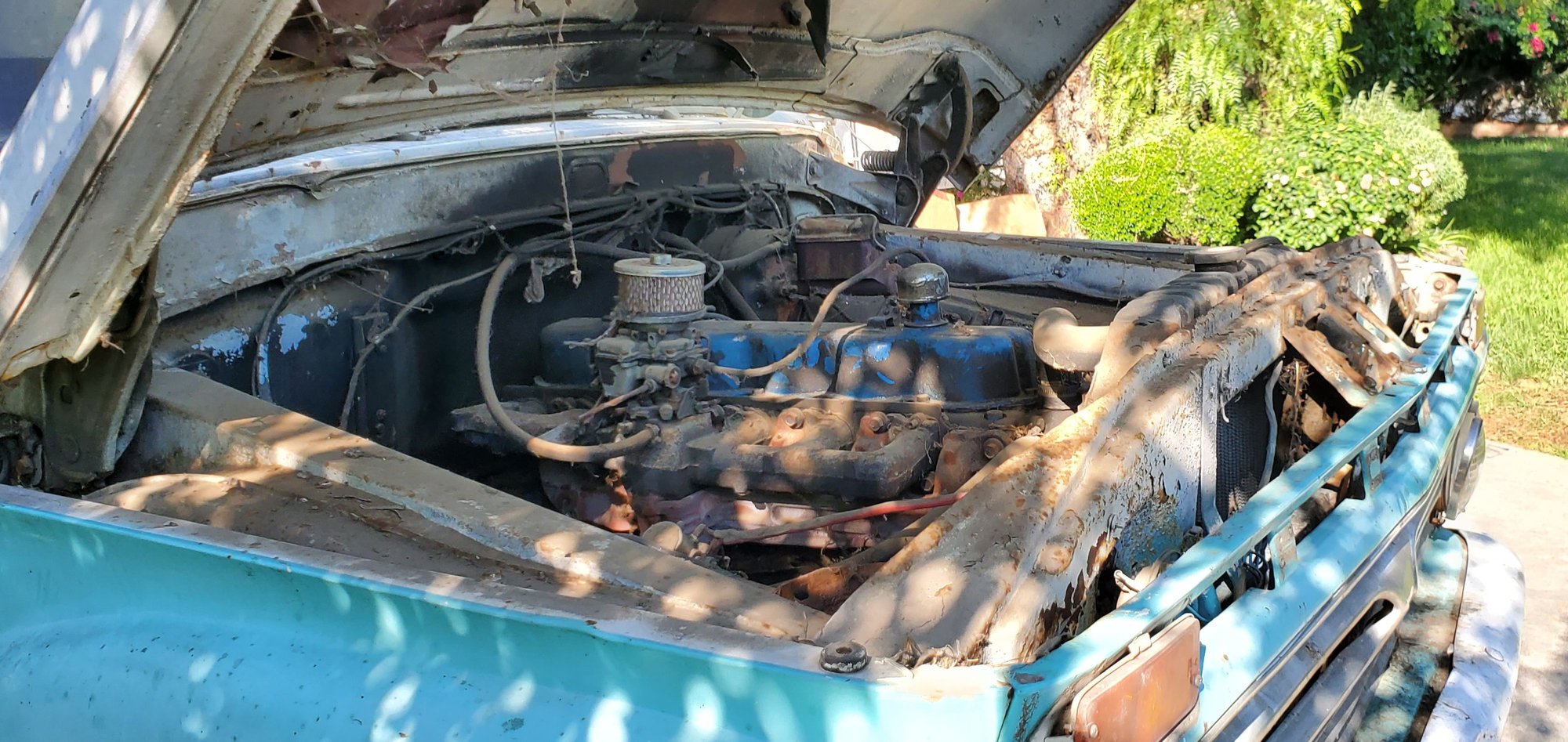

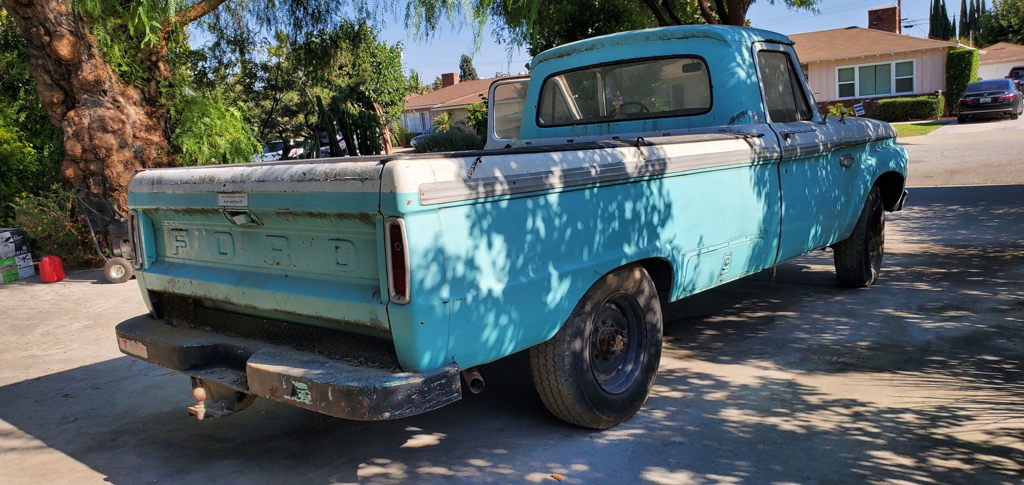

Here are additional pics of the truck that may lead to other observations and feedback.

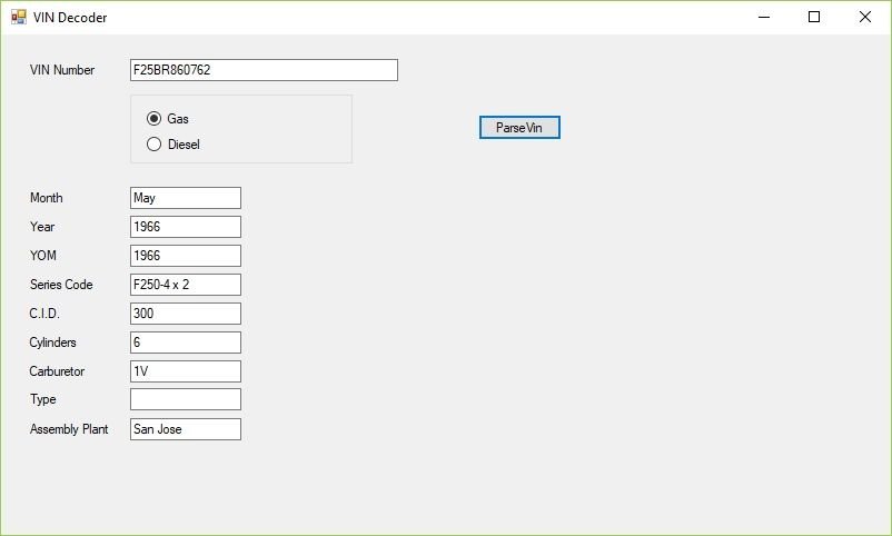

Here's the VIN portion of your warranty plate decoded. I'll do the other two lines in a bit. I need to extend my app to do the color, body, transmission and axle. Incidentally, it looks like the truck might have had a carb fire. Notice how the underhood paint is curling and a lot of black soot in the vicinity.

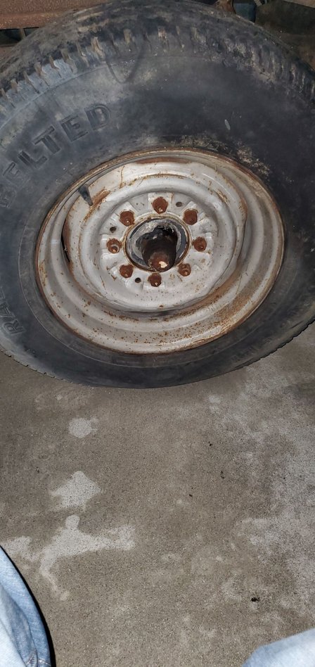

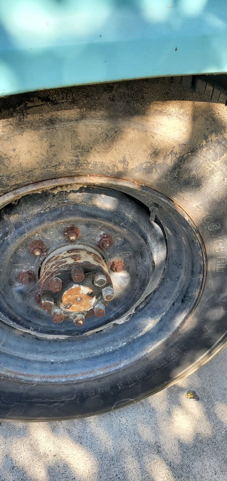

Here's the rest of the decode. The wheels are outies so they aren't stock but they look pretty good. I hope no surprises under the bed liner, but judging from a lack of overall rust through I suspect no issues there. *fingers crossed* for you.
F25 - F250 4x2
B - 300 1V 6 cylinder
R - San Jose, CA assembly plant
860762 - 1966 - Assembled May 1966
129" Wheelbase.
M - Wimbledon White
F253 - F250 4x2 6,000 Lbs GVWR - not technically called out in MPC but same rating as 1967.
D81 - D = Medium beige crush vinyl and medium beige cody pattern woven plastic - 81 = 81B = Custom Cab
C - Ford Medium Duty 3-speed - either and HEG-Z or an HEG-AE originally.
25 - Dana 60 4.56:1 (5.2M) non-limited slip
6,000 lbs. Gross Vehicle Weight Rating.
150 net HP @ 3,600 RPM
71 - Los Angeles, CA Sales Office

thanks TA I really appreciate your help. How do I know if its a camper special? Also you mentioned that my wheels are outies. What wheels are correct for my year and do you have a picture. I was planning on just painting these semi gloss black and adding chrome trim rings and a chrome center cap. Any idea where i can get rings and center cap that will fir these rims. The only think I don't like about these wheels is that they are 16.5 which makes it hard and expensive to buy tires. Was thinking about switching to 16's to make it easier. The picture is of the front wheel.

There is nothing to identify a true Camper Special since it was just a bundle of options that could each be had separately. About the only thing is if there is a faded Camper Special emblem on the front fenders. No guarantee even then, but it's something. If yours is not 7500 GVWR then it wouldn't be, but if it is 7500 GVWR then it *could* have been.
I'm going to run some wheels that are essentially the same, except they are innies - meaning the hub cap retention nubs point inwards.
The originals were a 2-piece wheel if they were a 16" 8-lug.
