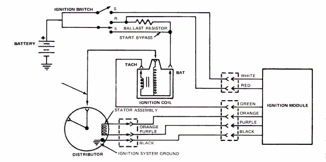

The DS-2 Distributor does not have a connector for the DS-2 module.
There was a wiring harness in between the two with the connectors.

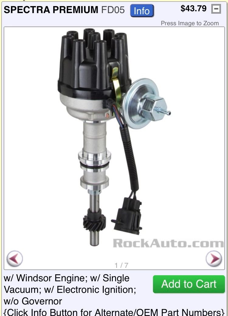

The FSJ should also have the module remotely located on the fender. I’m little confused what connector your looking for. You’re looking for a newer OEM 351W distributor that doesn’t have points? Here is one for an ‘88 Crown Vic
Dizzy.....
Jeep is the same way since it used the same system. My CJ is set up that way.
