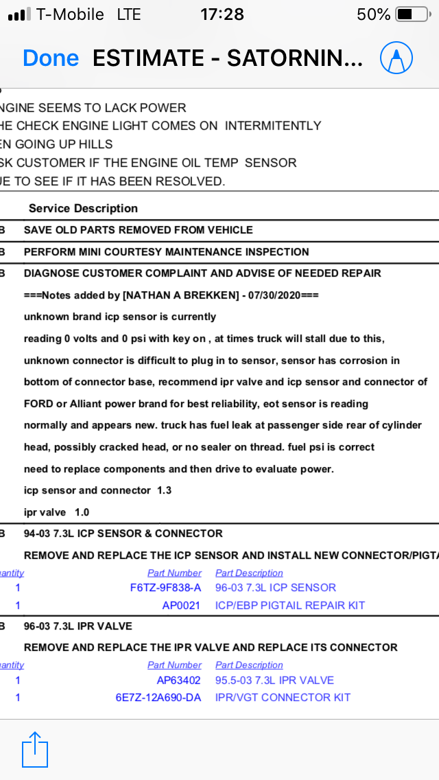

[img]blob:https://www.ford-trucks.com/8cf6b759-a6c9-4ee9-8f26-ca5854acc3b1[/img]

Do you have a way to scan for codes and/or monitor PID's?
Old Aug 19, 2020 | 07:46 PM
udsuth78's Avatar
udsuth78
Posts: 6,129
Likes: 1,919
From: Ponca City, OK
That is the shop estimate page correct? Did they do those repairs or is that as far as it's gone? Unless there is another page or two showing where they scanned for codes or hell anything else I'm suspect. It's unclear about the ICP not reading pressure with key on. If the engine isn't running it shouldn't read any.
Old Aug 19, 2020 | 07:50 PM
robjs111's Avatar
robjs111
Joined: Dec 2006
Posts: 1,388
That’s all strickly diesel gave me for estimate
