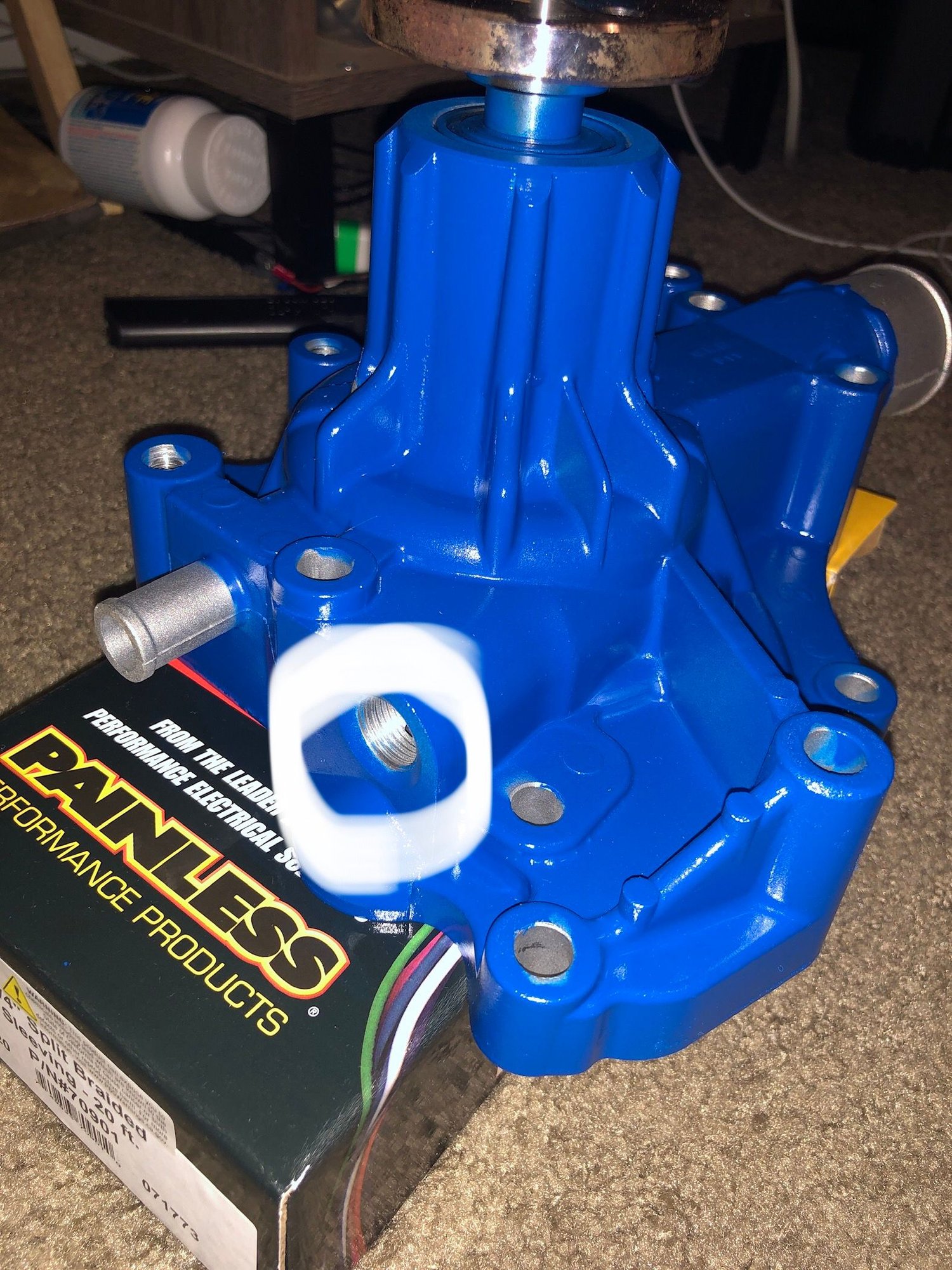

What goes in that threaded hole? It’s for a 351m I have a 1977 Ford F-250 also what are all the holes that needs to be plugged up?

Should be a fitting for your heater core line.

Yep, that's for the return hose from the heater core. Parts stores or hardware stores should have the fitting. It's a 1/2" NPT fitting w/ 5/8" nipple. Use PTFE paste on the threads.

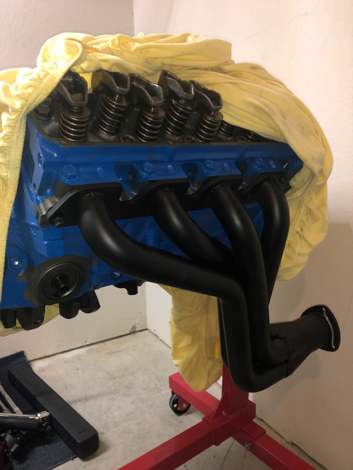

Oh, I see the staggered header bolts now. 351M or 400. I shoulda spotted that since I've got a 400 with headers.

sounds good! Thank you my 351 is basic the only thing it has a bigger cam in it and long tubes and 4 barrel carburetor

Hey, I just checked my spare water pump. It's not 1/2" NPT. It's 3/8" NPT. I confirmed it with a 3/8 NPT tap. Sorry for giving the wrong size earlier. I sure hope you haven't already ordered one.
