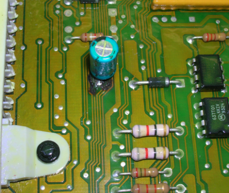

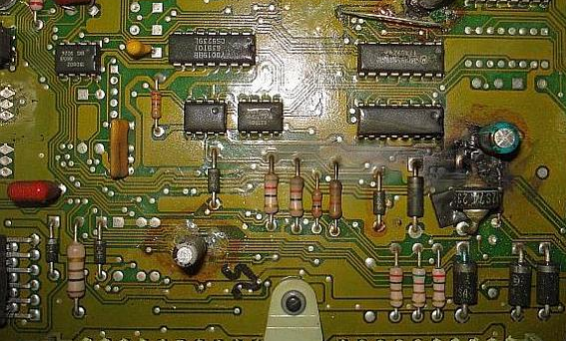

What do your capacitors look like on ECM, some time they are easy to spot if bad.
some you have to look twice

Yes one is blown but inside it's waterlogged. When I bought the truck that inner fender was missing so I put a new one in. The wiring is all fine I went through and cleaned it but I never pulled the computer until yesterday.

My 94 threw multiple trans codes from the time I bought it. Days-weeks it ran fine prior to a spate of hard shifts in random gears, then OK.
When it started slipping in any situation, (Zero trans codes) I rebuilt it. Worse when re-installed. Then I found leaky capacitors. Eventually needed a PSOM as well.
