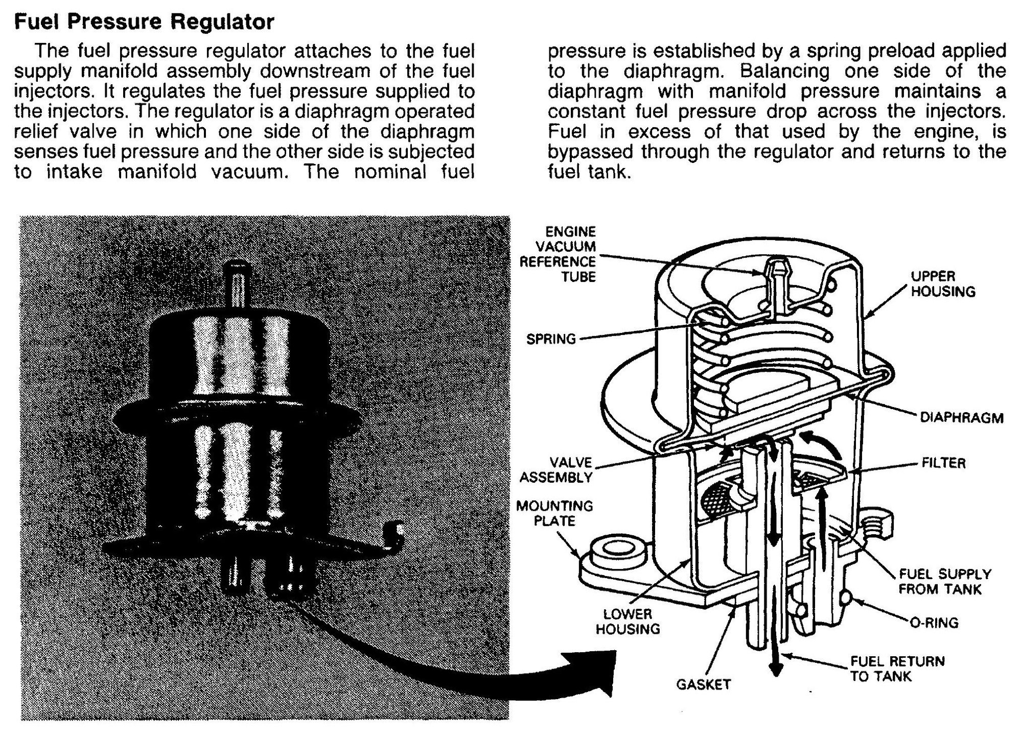

Hi All....My E-150 XLT Club Wagon 5.0 EFI has only 65k miles and has sat around a lot. Quit running awhile back. My friend got it running but left me with a few problems.
1-A 2.5 amp parasitic battery drain which turned out to be a bad Voltage Regulator....replaced that, ok now.
2-Rough/slight-surging idle.
3-Long cranking to start.
I'm too old to do much work myself but I can still analyze. I could have two separate troubles but am now looking to see if maybe one trouble could be giving both #2 & #3 indications. Thinking maybe ruptured diaphragm in Fuel Pressure Regulator, thereby sucking fuel into vacuum line during idle, and relieving fuel pressure during shutdown. Any thoughts?

A ruptured diaphram in the FPR will leak fuel out the vacuum port when the pump is running.
Loss of fuel pressure overnight isn't uncommon and nothing to worry about if the pump/s quickly build and maintain pressure during operation, pressure loss can happen at the in-tank pumps, at the switch valve(dual function resovoir) on the frame, or at the injectors but that usually results in wet spark plug, oil that smells of gas, and black smoke or otherwise obviously rich exhaust.

A lot of water has passed since I started this thread. All was working sorta acceptable and I was running a half tank of "SeaFoamForOldFolks" through the forward tank when I decided to get cute and switch to the rear tank with it's very old gas. Problem was the Fuel Tank Selector Switch was bad and no power to rear tank. Reservoir ran dry and engine quit....never to start again until this evening my friend came over and worked his magic. All he really did was spray some carb cleaner and got it to run a bit on that....then tested one of the injectors for pulsing...and disconnected the fuel filter and let both tanks spit a bit of fuel out. Now the durn thing will start and run on command! We'll see what the morning brings. Oh, BTW the FPR seems to check out ok....that was my original fear.
