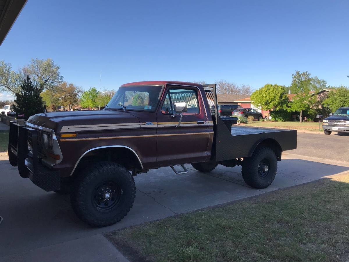

Now that I’ve got the other major issues worked with my 1979 F-250 4WD I need to address brakes. My truck has dual piston out front and drums on the rear. Brake pedal feels ok and I think vacuum is decent enough (12” at idle) but I have to stand on them to get a decent stop. If I really stand on them it will lock up the rears quick. The booster appears “newer” and I replaced the leaky MC and was able to bleed backs and pass front. Driver front bleeder screw is corroded (caliper will be replaced) and I was afraid I was going to break it so that corner may have a slight amount of air. Pads are in good shape. All lines and proportioning valve appear to be in good shape.
Questions: Should I just replace the calipers/pads up front with the reman stuff I can find on Rock Auto or is there a better performing setup? Been searching for new stuff but not finding anything obvious. I don’t need anything crazy just factory type performance would be great.
Truck is 4wd, 460/C6, mild lift with 35” tires so plenty of mass to stop.
Thanks in advance.
