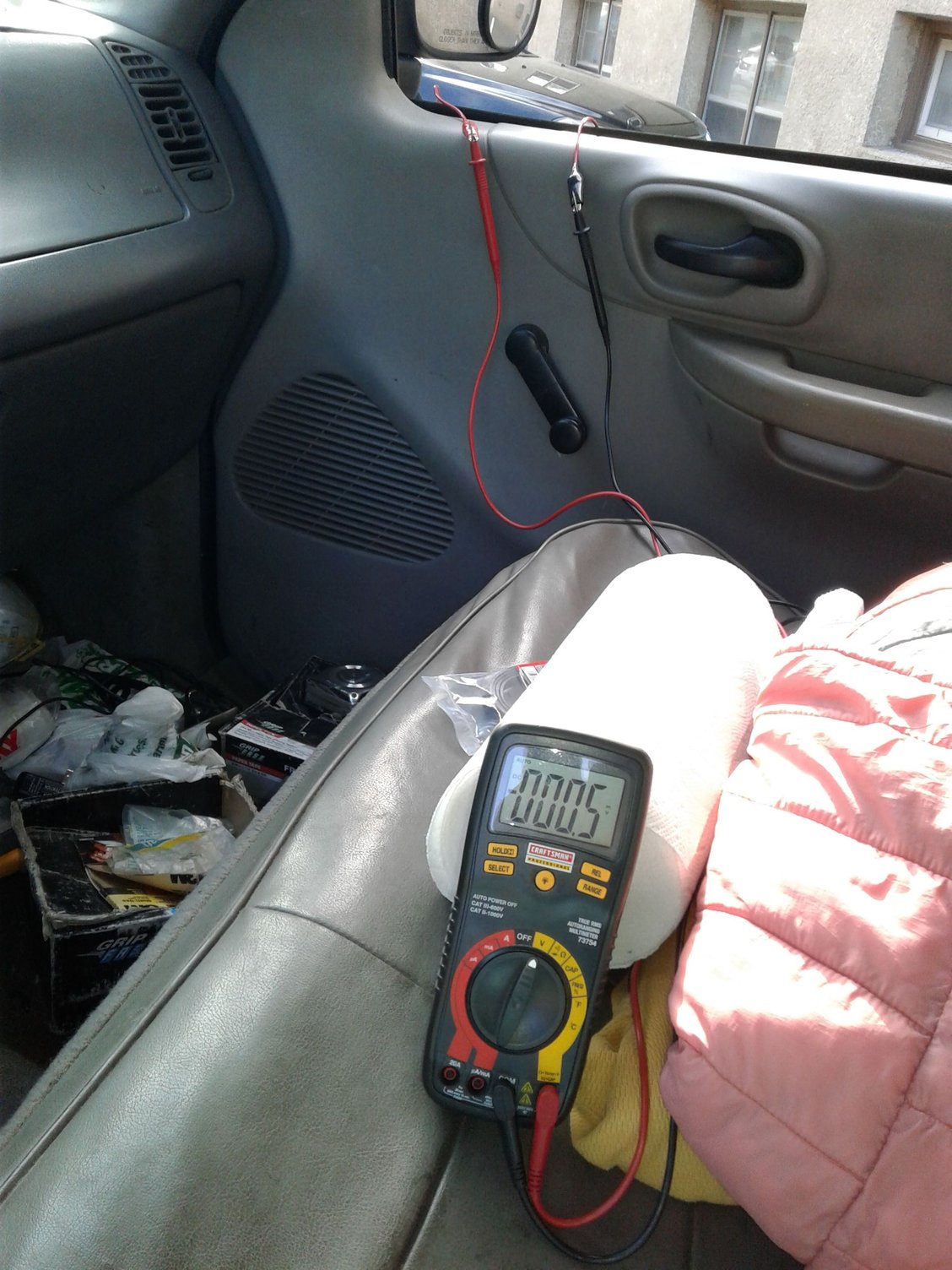

Some guys here advise about voltage drop testing. TBH how to check say + battery cable. Put a pole at positive battery terminal and another pole at starter red one I guess. But what than should car work or somebody crank engine to see some drop. But I have only one click, do not know if voltmeter can read anything in time of one click.
Am I OK to replace battery with steady 12,3 V and should it be reasonable next step? First step obviously wasn't reasonable. Live and learn.

Well Tuesday had problem start with new battery that had 12,4V than. After driving it went to 12,6V and pickup do not have problem starting. Obviously something is not right still. So I decide to go with that voltage drop testing, first time in my life. Connected alligator clips to a 12' and a 6' wires. Connected first negative at battery to negative at starter and record reading with my phone, was sitting in car and turning key. Negative cable had maximum 0,3V at video that I downloaded to my computer.
Connected positive at battery to positive at starter and had 3V maximum reading in video. Obviously that damage that I sow when was replacing starter drove 3V from line. I will try to cut bad part and add another wire when will not be hot. Pickup start for now, will do it somewhere in September.
About Voltage drop testing. How hell I didn't try to learn about it before. So easy and convenient. I'm carpenter contractor and try to learn new technics often, something that I may need in life. How hell I miss this one so far.
Edit. Of course before did voltage drop test first connected jumper cables to battery terminals to see if will give me same reading like multimeter test probes only.

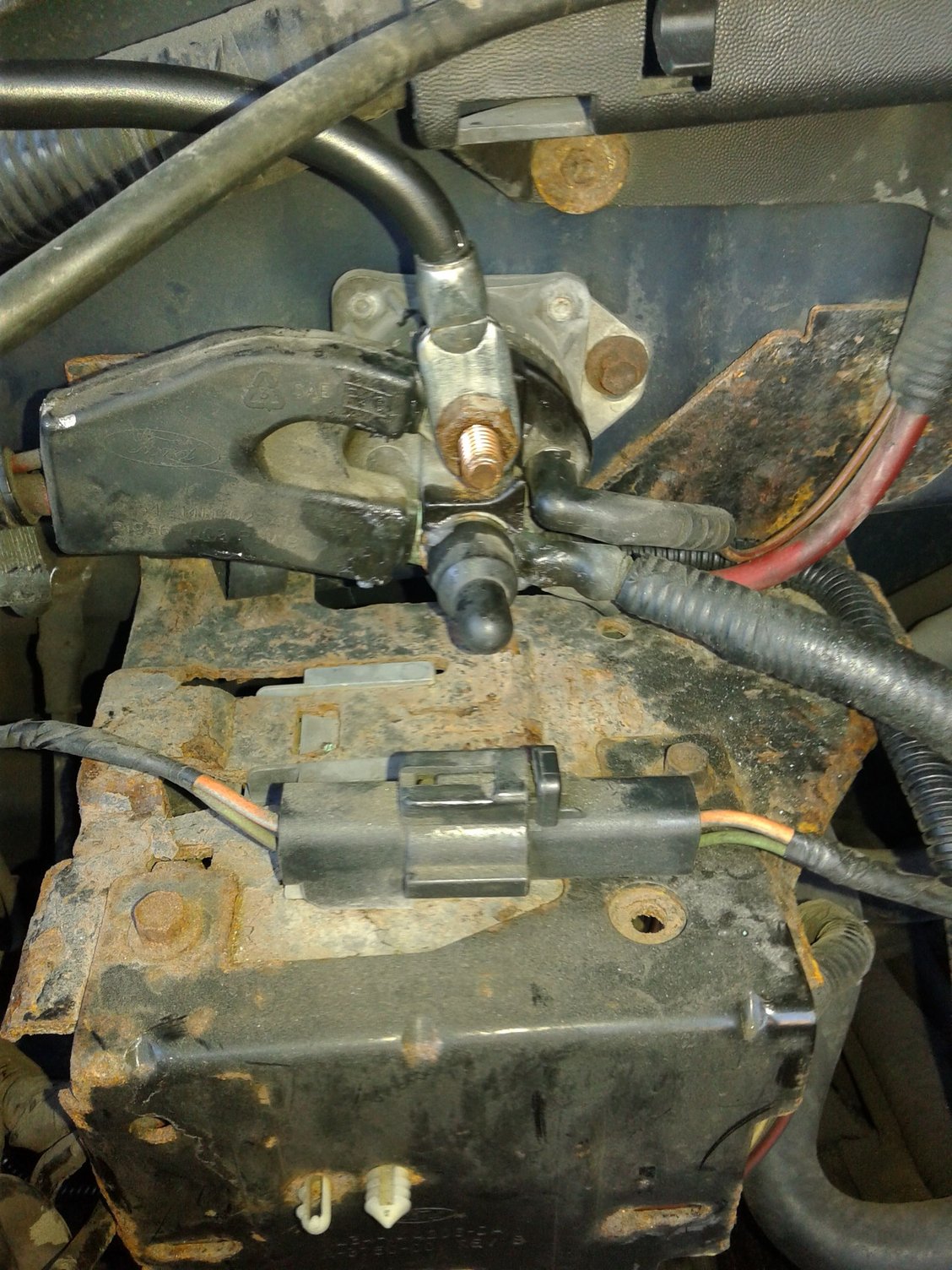

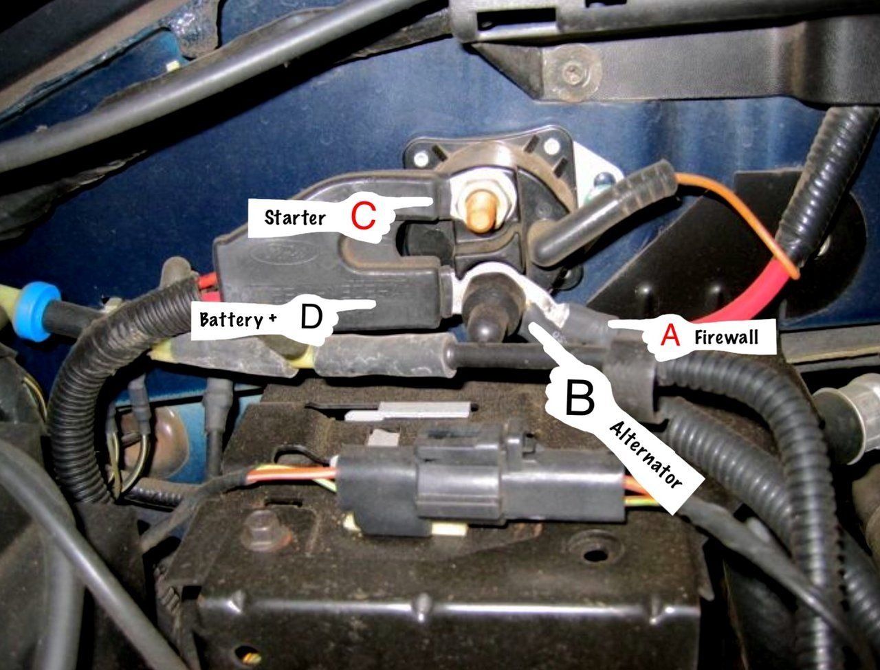

Well went to do it. Used this schematics, same is in Hanes manual.
First try to check if I have enough of length of cable. Didn't detach + and - at battery. When I touched B+ with connector of new cable I heard loud click (from solenoid I guess) and see some strong spark. Stop all and start pickup to check if I fry something and all is good. I think when I touched b+ at starter another end of new cord was touching ground somewhere up and basically I tried to jump start starter. Ok.
Then I connected new cable. Upper end to C and lower end I put below original connector of old cable (that I will leave on of course)
All easy so far. But now things go strange. Connected positive to battery and than try to connect negative to. When I touch negative post with connector I had strong spark and it look like solenoid click again once. Once is because I barely touched negative battery post with connector. I guess would even start if I would hold it. So I guess I did jump start situation for starter again. Tried barely touch connector to negative post again and again spark, but with no click this time as I minimum touch post to connector. So I pull out new cord for now.
I think I connected it properly from C in picture 1 to B+ at solenoid. Only, distant, second explanation would be at B+ I put new connector first and because it is fat it managed to touch that path in picture below that I marked with arrow. I didn't rearrange B+ connection for now, old first and new over. So any idea what can be. Still always it look that I didn't fry anything with this, all together, 3 sparkings.

This is big. This guy at another forum made "big 3" and than say add new wire from solenoid to relay. He said this
"Once you have located the bolt run your heavy gauge wire from that bolt to the starter relay bottom bolt (on your firewall). You should already have two terminals added here, this will make the third. Current is always flowing from this location so be careful when doing this an not hit your wrench on the top bolt(ignition lead). Once you have the terminal connected to the bottom bolt, securely tightly and enjoy your work. This will dramatically increase the amperage going to your system and your starter for long lasting power."
So he said that I should run wire from B+ to STARTER RELAY BOTTOM BOLT. Is it this true. If so how f is possible that Hanes manual is wrong.
This guy mistakenly put alternator wire (B in above picture) over starter wire C and fry starter. https://www.f150forum.com/f12/starte...d-fuse-440103/ So most likely I put starter wire properly to upper post at solenoid. Maybe I get just scarred from stronger spark. As I said I heard one click form starter when try to connect negative, maybe it is normal with new fat cable.
Well when look purely with logic battery + and alternator must have direct path. Third cord go to firewall. If would starter cable go to lower post to than nothing would go at upper cable. And plus starter and alternator cable can not be at same post as it would be direct connection from alternator to starter and everything in car should be protected from alternator voltage spike through battery. So next weekend will just rearrange connectors at B+ (starter positive post) and connect cable hopping for best.
