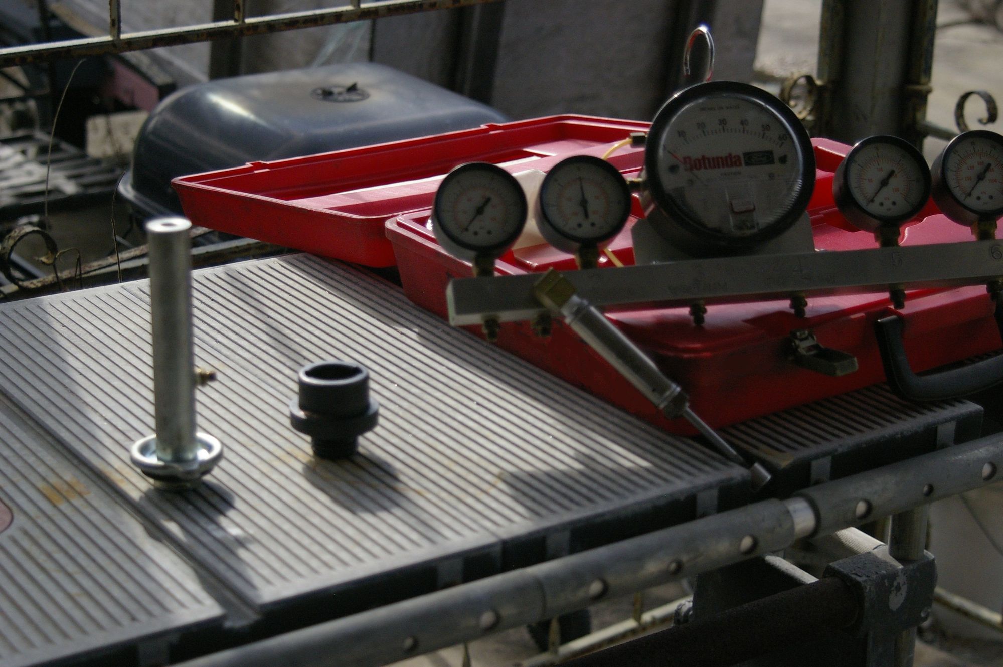

Since most blowby circulates through the CDR valve then into the intake stream you have no idea how much blowby you have unless you first block off the CDR valve so all blowby is trapped in the crankase. Then to do it right, a reading is taken with a manometer plumbed into the oil fill tube. If the reading exceeds 6" at 3000 RPM blowby is excessive. Can't see how switching oil would have any effect, engine wear is engine wear regardless of choice of oil.

6" of water is only 0.2 PSI

You're big on manuals, look it up. I've tested quite a few DT466's and their factory spec is exactly the same----6" at max no load RPM.

I use a Magnehelic gauge myself, with a pair of adapters for the screw on oil filler cap/
There are several DIY blow by testers online that are easy to construct/
Anyway you won't know what it is until it is measured.
