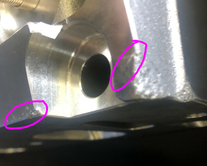

He said it was picture 6. I don't know, I think they are 1,600 for bare heads new.
Here is what I see:

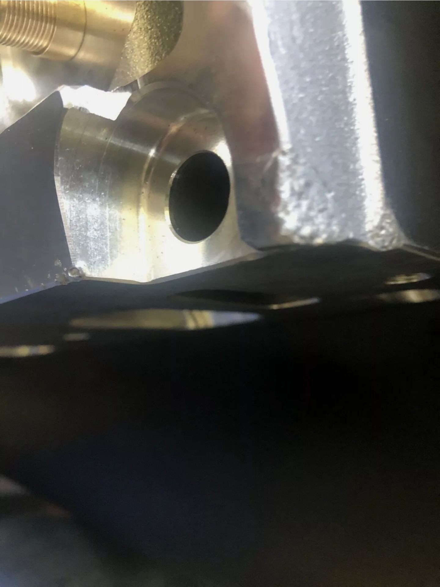

Old Aug 14, 2020 | 08:53 AM
caravaggio2000's Avatar
caravaggio2000
Joined: Apr 2018
Posts: 1,244
Likes: 12
This is the rocker mounting surface, right? Does anyone forsee a reason this flaw would cause an issue?
Old Aug 14, 2020 | 09:21 AM
mark a.'s Avatar
mark a.
Joined: Mar 2004
Posts: 8,922
Likes: 153
No, it's a head bolt hole. I don't see any problem but then again it isn't sitting in front of me. One should always psi check any new head.

Looks like it was dropped on the corner. Probably just cosmetic damage, but it's the Internet so buyer beware.

I would be more concerned about the port job... Someone got to happy grinding near a few valve guides and there is at least one intake port that looks cautiously thin near a water jacket.

All right, thanks friends. I'm going to pass on these. Too many one word answers from the seller. If one of you wants to pick them up, feel free.
