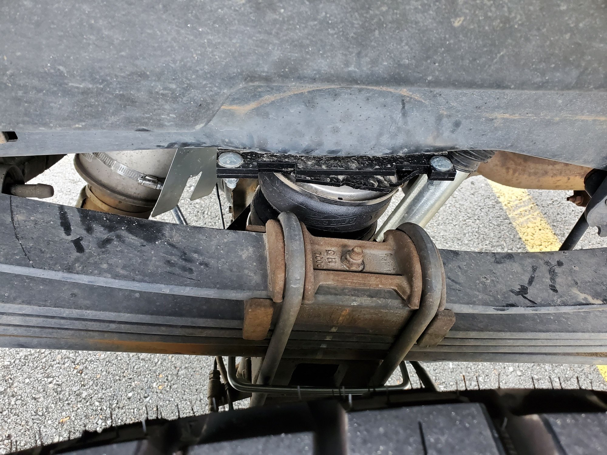

I'm running Airlift 5000 Ultimate Plus and with the Wireless 2 set up. You don't need the 7500 on an F250 you can't even take a payload anywhere close to that. I have a 2017 CCLB F350 and I'm loving the setup.

I have more of a Frankenstein approach for my 2020 F350. Using Firestone RideRite Red label bags, ARB twin compressor, and a Viar tank. The ARB compressor is a bit overkill, but it'll push a lot of air. Makes airing up / down the truck plus checking the fifth wheel tires pretty quick and easy.
