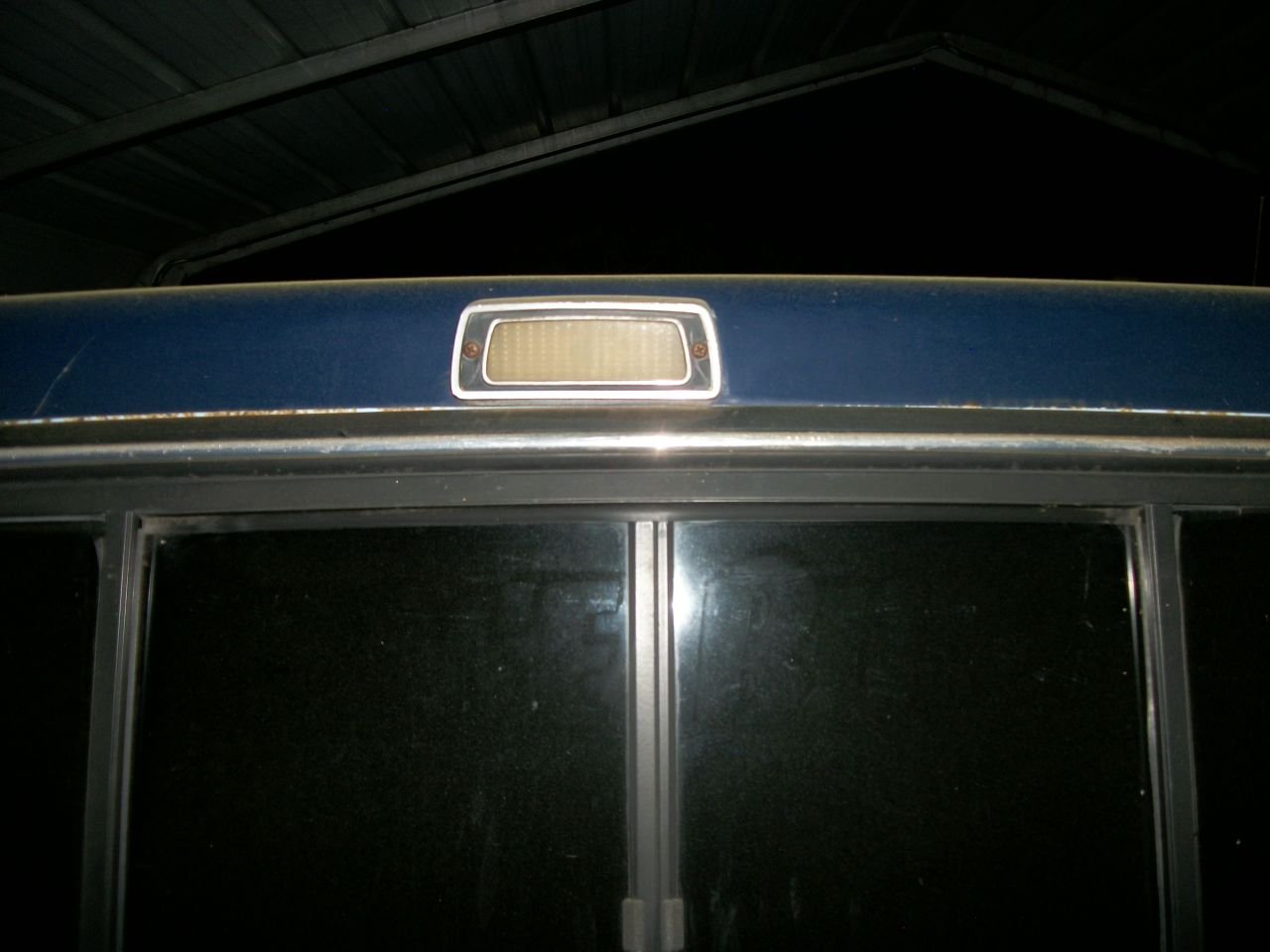

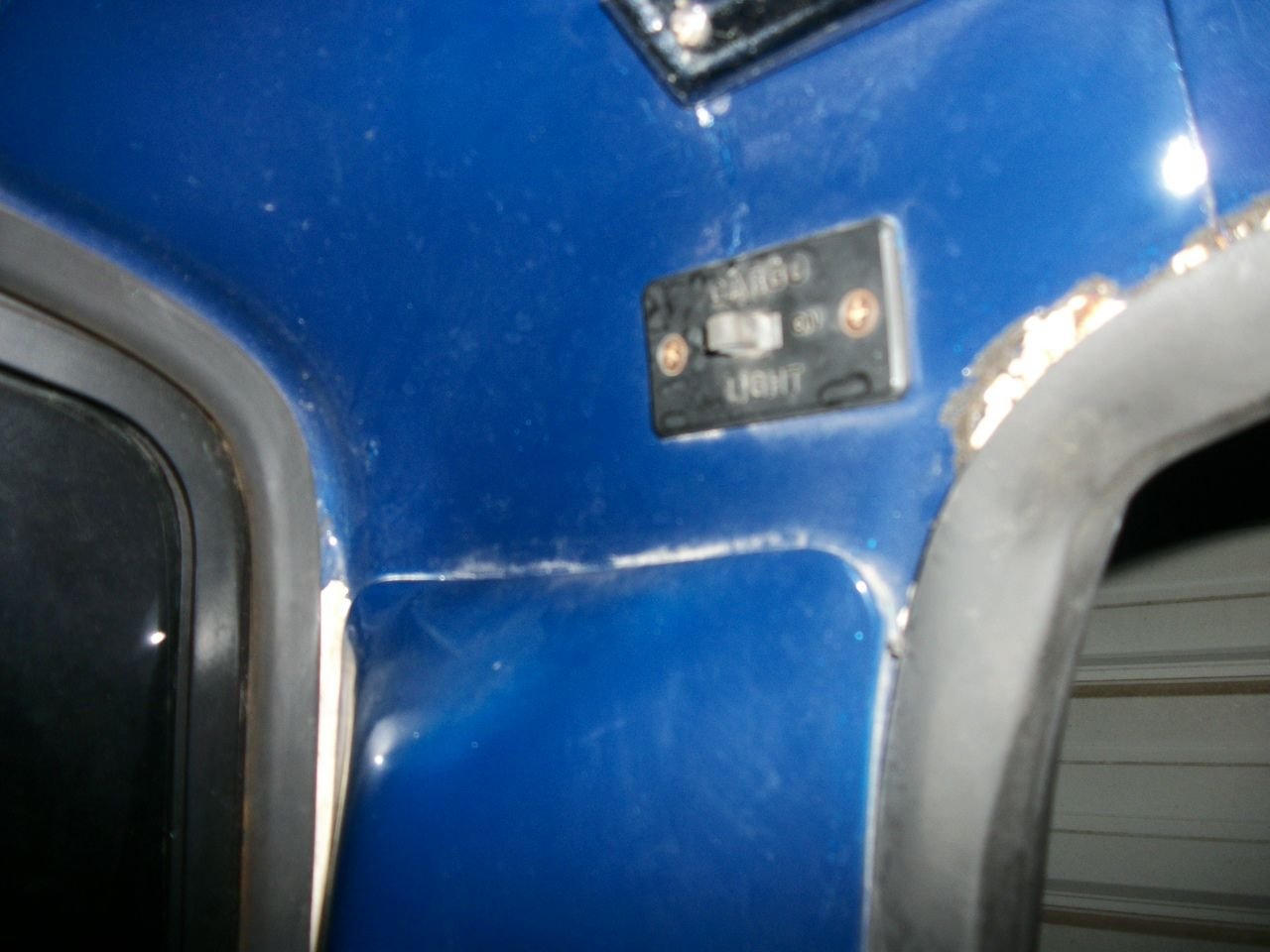

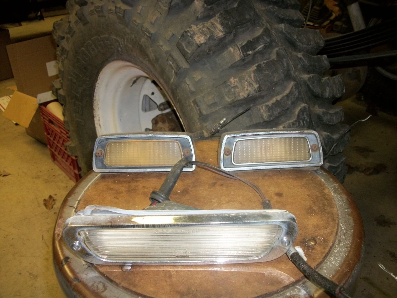

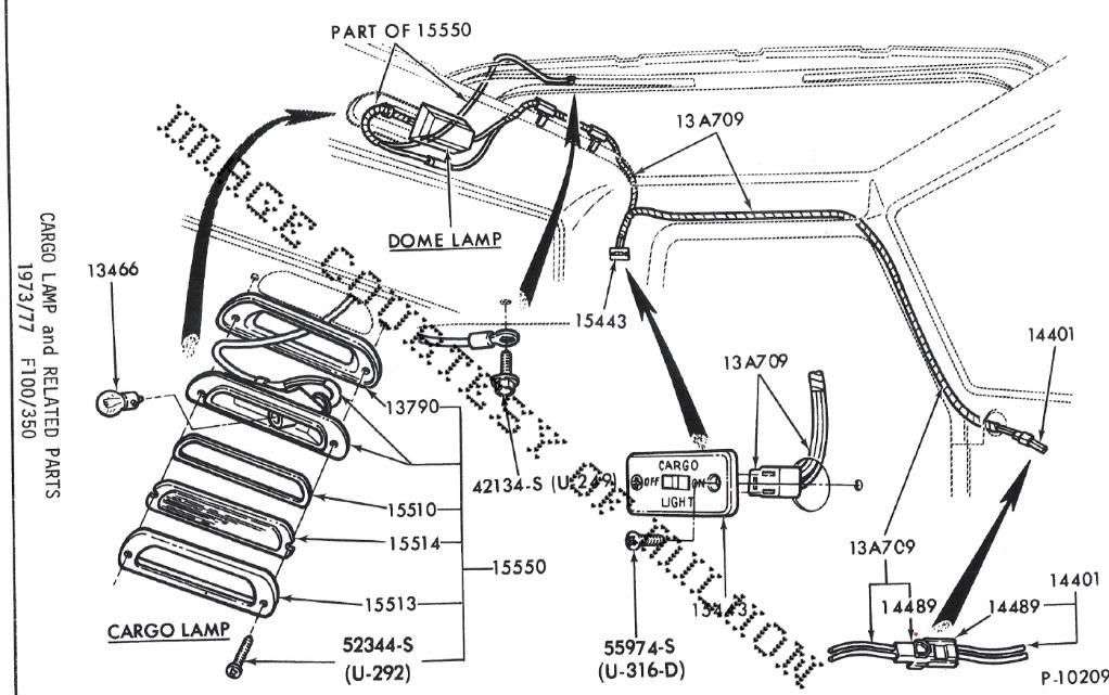

Yes the interior "dome" light is controlled by the headlight switch. Some of these trucks have a seperate cargo light switch in the B pillar. It turns on a back of the cab mounted "bed/cargo" light. 73-77 bigger light glass lens, 78/79 smaller light and plastic lens. The OEM switch is cheap and breaks easy.

The cargo lamp was introduced in 1967. It was an extra cost option, so many trucks do not have it.
The bezel, lens and body are the same as the 1964/65 Thunderbird backup lamp!
