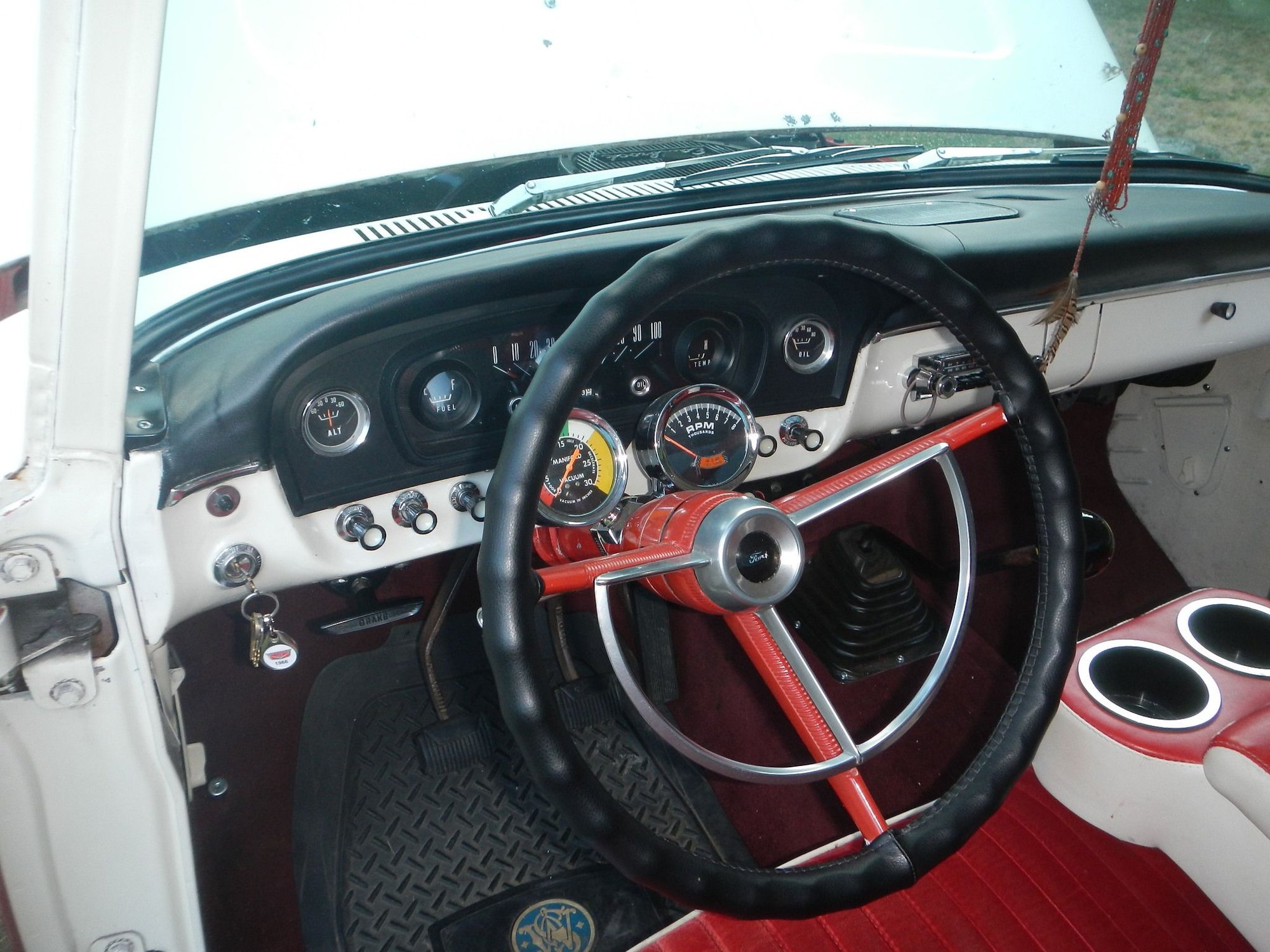

Tachs and vacuum gauges are very usefull and don't have to be a sore thumb. I tend to monitor them more than the other gauges. I'm getting 14mpg highway, not so good around town with a 410.
