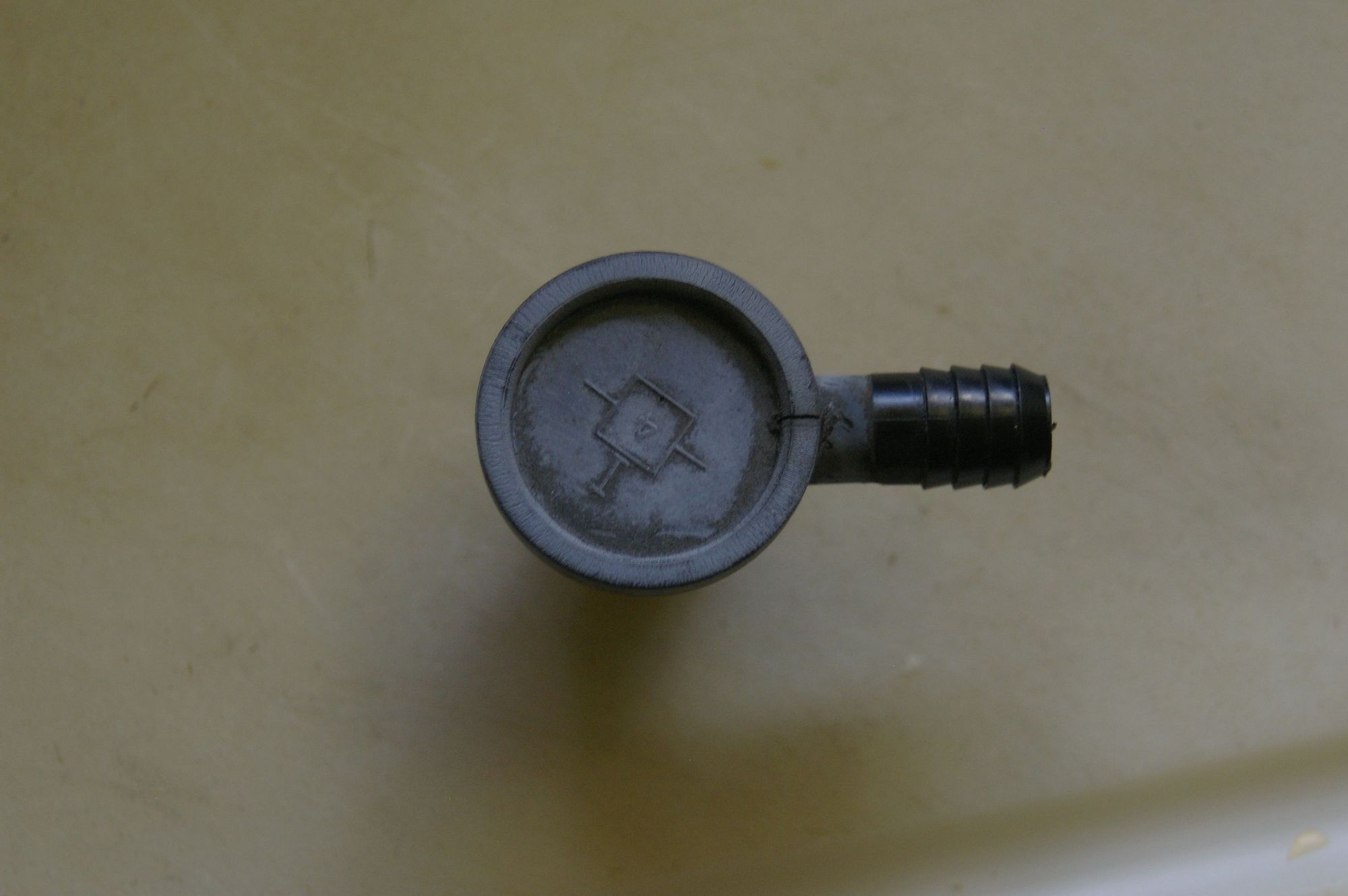

inspect the Booster Check Valve for a leak.... I've posted on this before....
NOTE the small crack on the RH side at 3 Oclock
