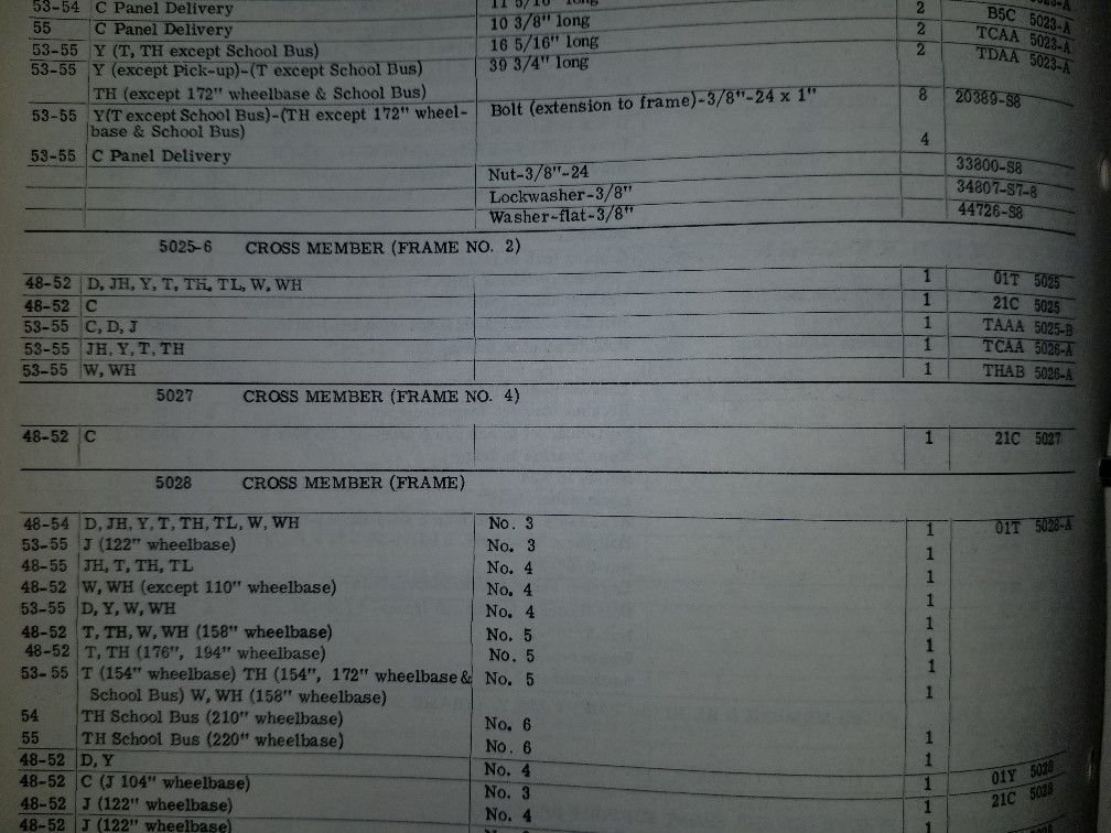

Is the rear frame cross member the same between F1 and F2?

According to the Ford Chassis Parts Catalog, they are not the same. F1 is it's own part, F2-3 are the same. That's not to say they couldn't be made to work in a pinch. The F1 part would be a lighter weight part.

Can you show me that documentation. I have a guy wanting to sell me an f1 piece and swears its the same

Sure. Model C is F1. Model D is F2, model Y is F3.
Crossmember #4 for F1 (rear crosmember as shown in the diagram below) is 21C 5027
Rear crossmember (#6) for F2-3 is 82Y 5035

they look the same but maybe thicker material can you measure the piece the seller has

  1. Will it fit? Maybe the F2/3 cross members are taller.
Will it work if you don't haul heavy loads?

Thanks for the pic. Looks like I have the cross member. I thought maybe someone cut it off when they were cutting the frame rails off. Wayne, do you have a pic and p/n for the f2/f3 rear express bed cross member under the tailgate.
