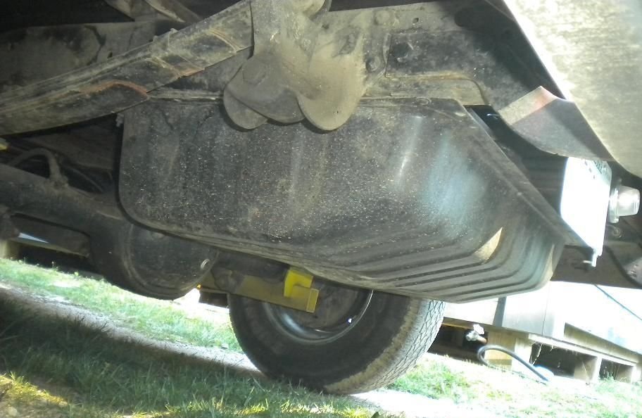

I put the Mustang tank under mine, do not remember having to move any cross member. Fill neck in bed floor at bed level so it doesn't get in the way.

that sounds good. any picture of the install or bed fill neck?

Only have this 15 yr old pic. Don't take a lot of truck pics...Excuse the nasty...I live on a dirt/gravel road and it's a bitch to keep clean.
