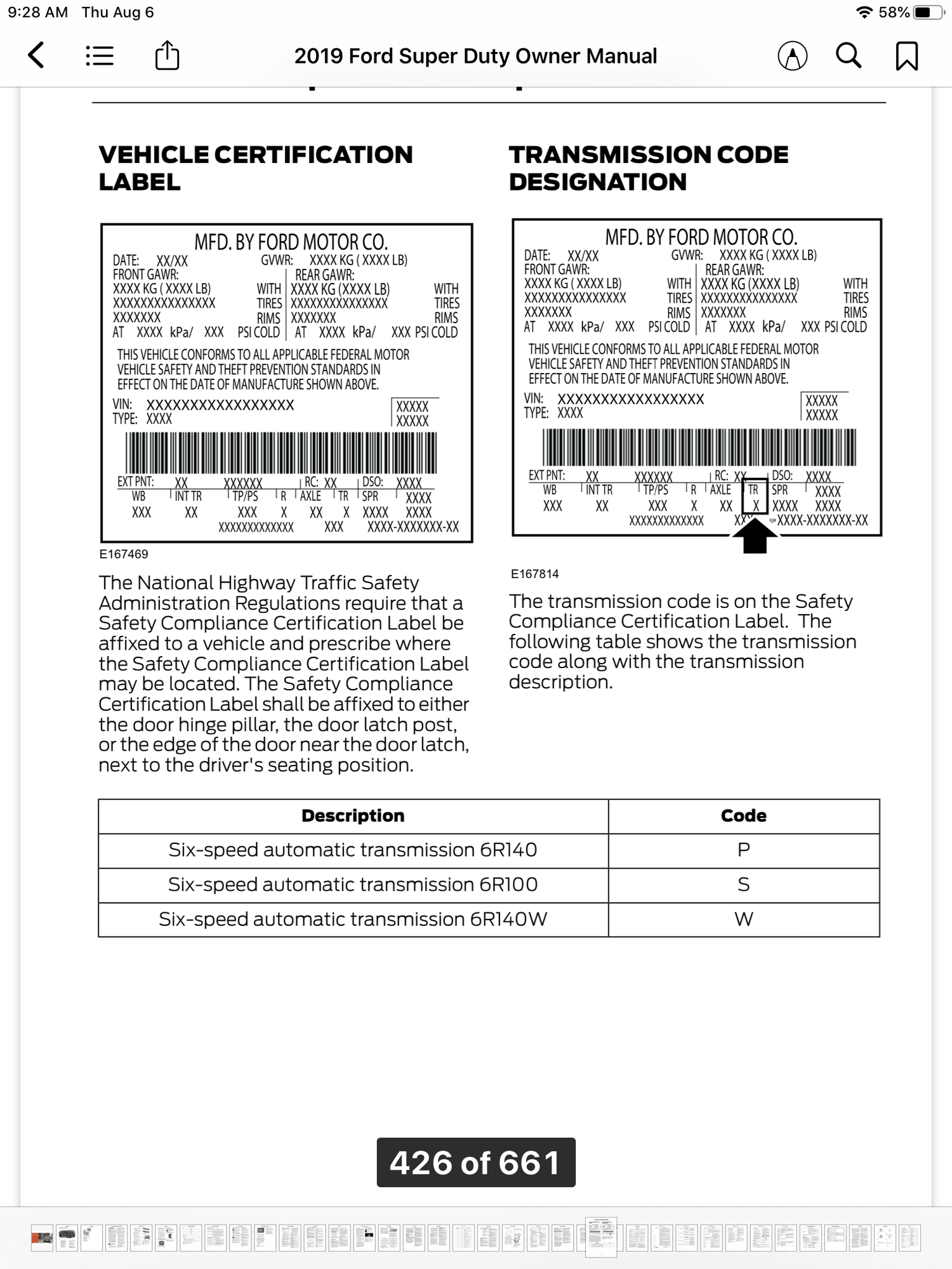

The 2019 Ford Super Duty owner manual lists three AT codes for the 2017-2019 pickups, including an “S” code for the 6R100; see below.

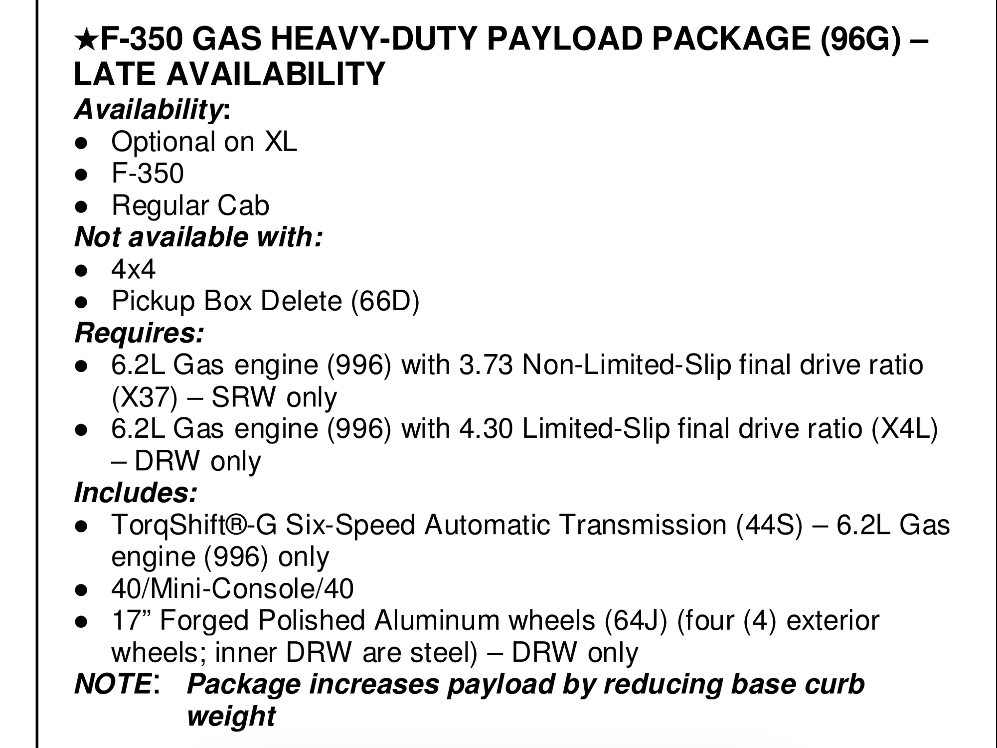

Ford isn’t phasing out the 6R100 TorqShift-G just yet. It’s still the standard transmission in the 2020 F250 with the standard 6.2 gas V8. To get the new 10-speed AT in a 2020 F250, you have to order the optional 7.3 gas or 6.7 Diesel.
Of special note, the transmission is also part of the Optional Gas HD Payload Package offered for the F350 Regular Cab 4x2 pickup, both the SRW and the DRW; see info below.
