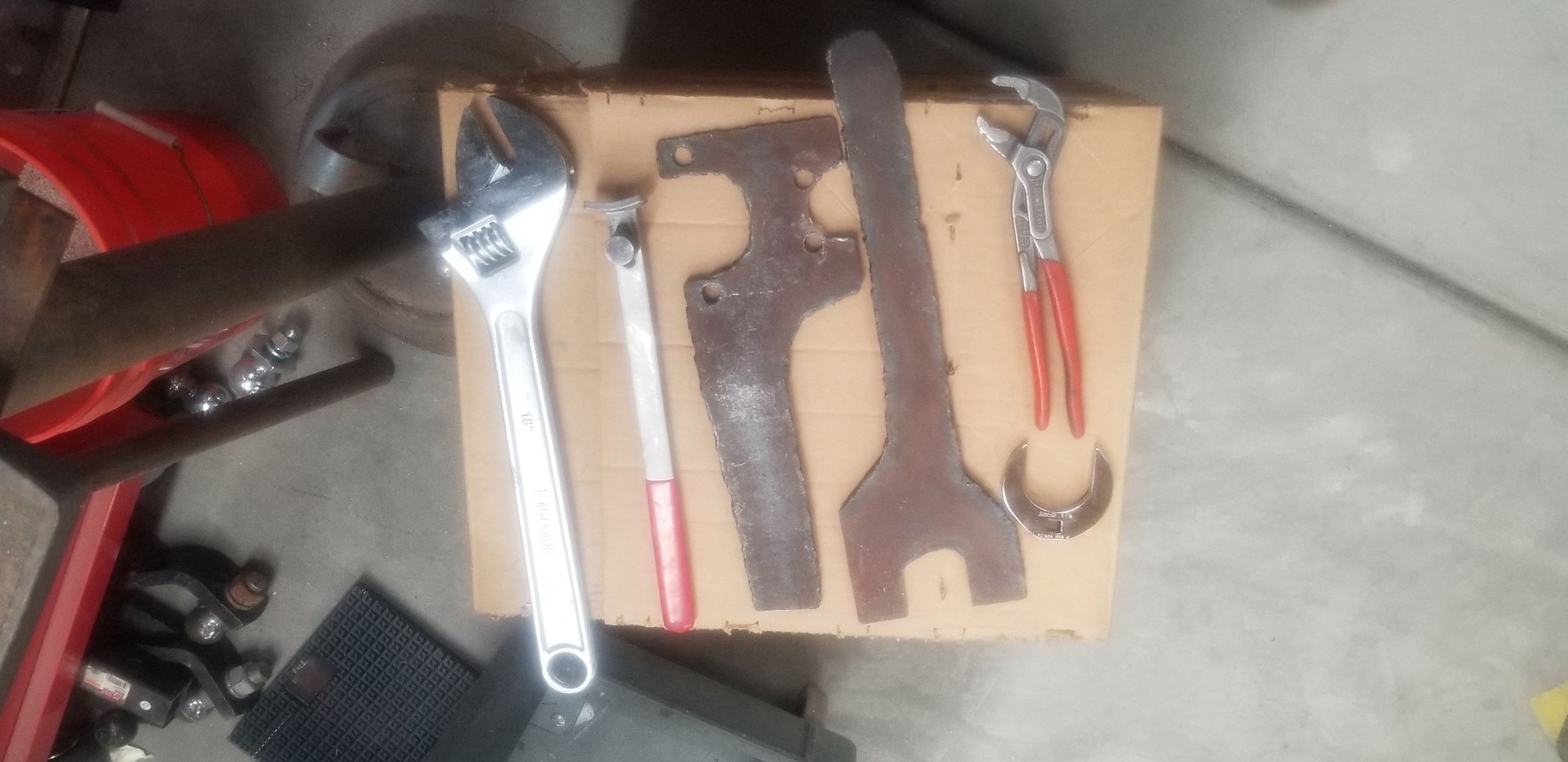

Originally Posted by sjbj
Can anybody recommend an affordable tool/wrench/part number to replace the fan clutch on these 7.3L vehicles? I've used the air chisel method in the past when in a pinch, but really looking for a better alternative. Wouldn't really want to damage the nut on a new clutch.
Well I've found a number of options. You can rent/borrow the tool set from Autozone, I've also used the large crescent wrench from Harbor freight while holding belt tension or holding the pulley from turning with a flat piece of steel with two holes drilled to line up with the bolt heads and a half moon cut out of it to allow it to slip around the shaft. On my 6.9 I had to make the tools in a barn when I broke down in rural Vermont using 1/8" sheet, O/A torch, grinder and a file. I've since modified the pulley holder to fit the 7.3. Very crude looking but they work. I've since picked up a crow's foot to fit the fan clutch but haven't had to use it yet, but it's small enough to keep on board and I always carry a set of sockets so I have the drive handle to use on the crow's foot.

From: Arizona
Loosening the 1-7/8" nut is the easy part, holding the pulley is a bit harder. You can see my crude home made pulley holder that slips over the bolts, one side for the 6.9 and one for the 7.3. The crude thin wrench would work for the 7.3 fan clutch nut if I opened it up a bit more to 1-7/8" but I just used the big crescent. You can also hold the pulley bolts with channel locks although a bit tricky to hold everything down in there. 2nd in from the left is a pulley holding tool that Harbor Freight used to sell but for some reason discontinued now, it's worked great on some pulleys and not so great on others. You can buy a much financier one that has a pivoting leg and various screw in posts to fit your needs, OTC makes one. The 1-7/8" crow's foot might prove to be tricky with an ordinary socket handle, like I said I haven't tried it ever.I may weld up a square drive on piece of flat stock to fit it, or just weld a handle onto the crow's foot.
Like you, I like to be as self sufficient as possible, you never know where you will be when you break down. Even at home it is nice to just grab your own tools instead of driving somewhere to rent. Those home made tools for my old 6.9 sure got me out of a bind when I was broke down in the country! Thanks to a friendly local letting me use his stuff!
