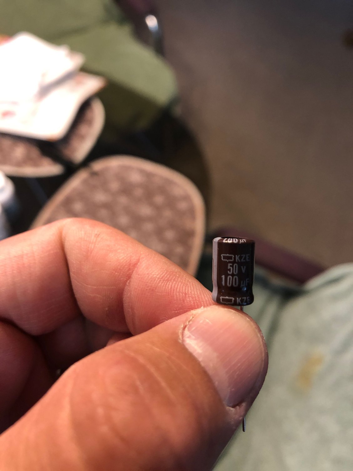

I had a buddy replace 1 obviously bad capacitor. It had shrunk on the PSOM. the bigger of the 2. Speedometer is working great

Here’s the new capacitor. If you look at the shrink wrap around it you can see it reaches the top. If you look at the circuit board below the capacitor shrunk and there is a silver color exposed towards the top. I didn’t realize they could shrink as well as swell. My buddy said it was bad. He was right. Speedo back to normal. But OD light still flashing.

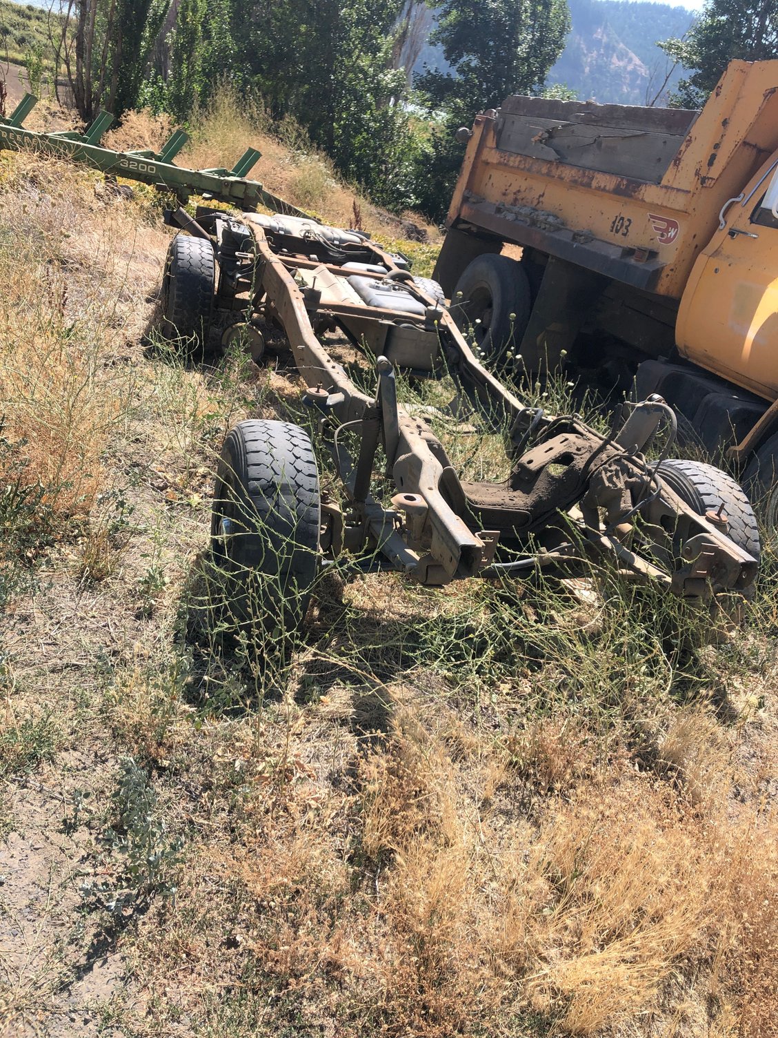

friend with the laptop has a f350 frame and axles. I robbed the VSS from it. Now I just gotta figure out how to convince him to give me the front axle too 🤘🏽😝
I’ll report back. See if the VSS changes anything
