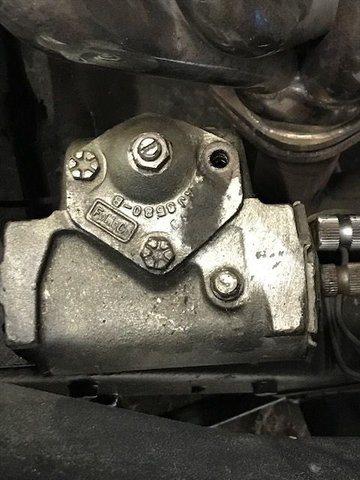

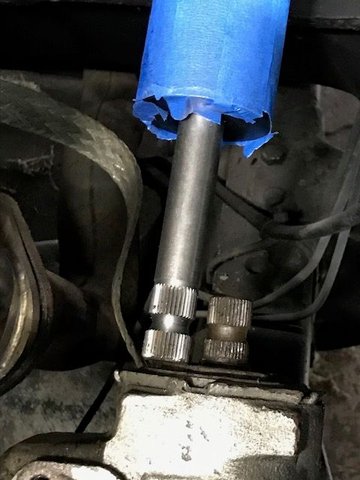

There are two different gear boxes, I believe I have the bendix box and my steering column is to long. I'll take a pic. thanks for the help. Let me go take it.

Here are some pics.

If it fits ok in the cab take it to a machine shop and they can cut it down and make a double D then connect together with a rag joint.

Before cutting the column suggest measure the length of the 'i did it', to include the Rag Joint, this should provide a figure you may be able to work with in determining whether to keep the shorter Bendix box; although, they can be problematic, or go with the longer manual or power steering Ford/Saginaw box, seem to recall they are both the same length, may need to swap an engine perches if convert to PS; perhaps more knowledgeable member can advise?
May be able to salvage a manual or power steering Ford/Saginaw box at a wrecking yard or most Auto parts stores carry both remanufactured.
Give FTE members updates on how project is progressing!! .

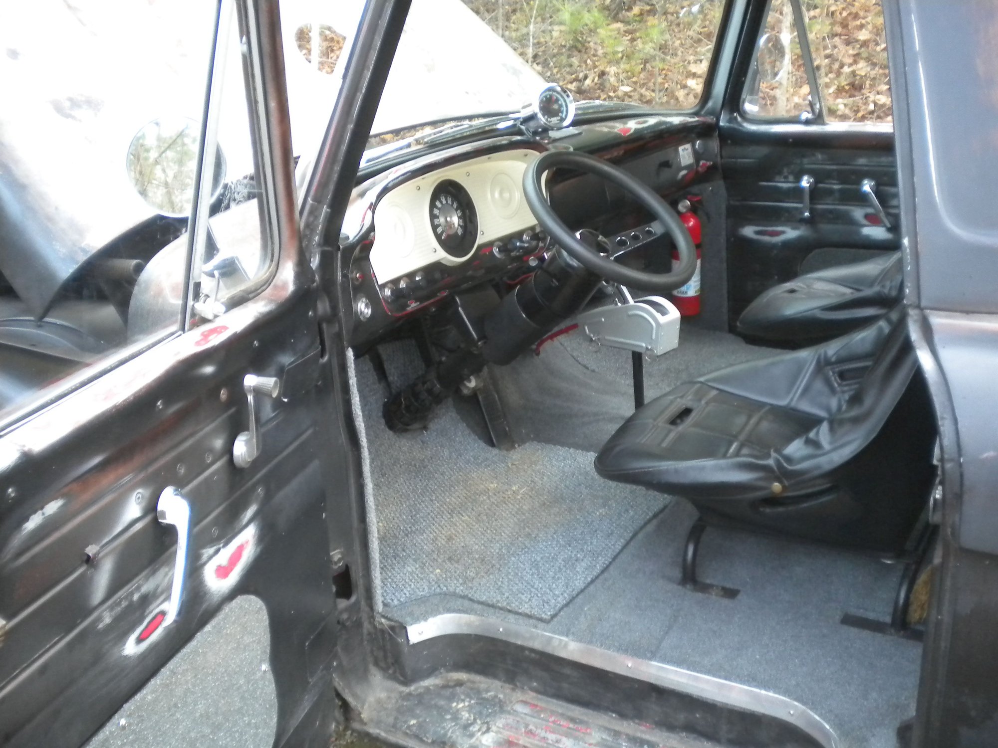

Will not help you with your problem, but I cut down a 77 Towncar column to work in mine,

Looks cool, My buddy knows a guy with a machine shop, gonna look into that like mentioned above.
