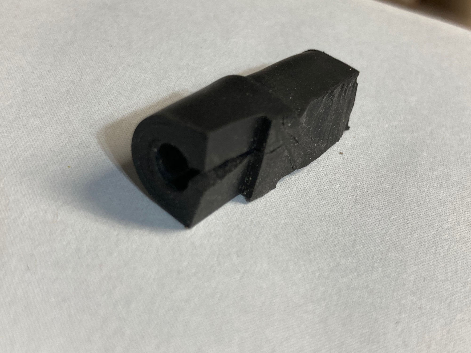

Finally got around to fixing the lumbar support on my 98 Explorer. Could hear the pump run and air hissing when the switch was pressed. Wound up being a split connector where the tubing pushes onto the switch. Only one side was split so I cut the connector in half and attached the hose with a piece of vacuum line. My sciatica is going to be very happy
