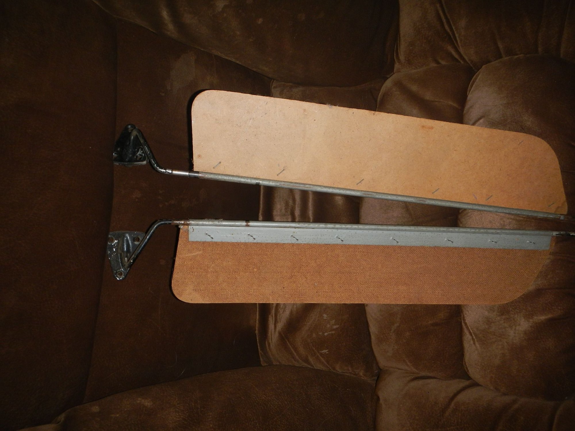

Just acquired a used set of sun visors which all the hardware is there and all good, but they need to be recovered. I see that originally on the outside was made of some type of cardboard. What material is this exactly? I can probably make my own instead of having an upholstery shop do it

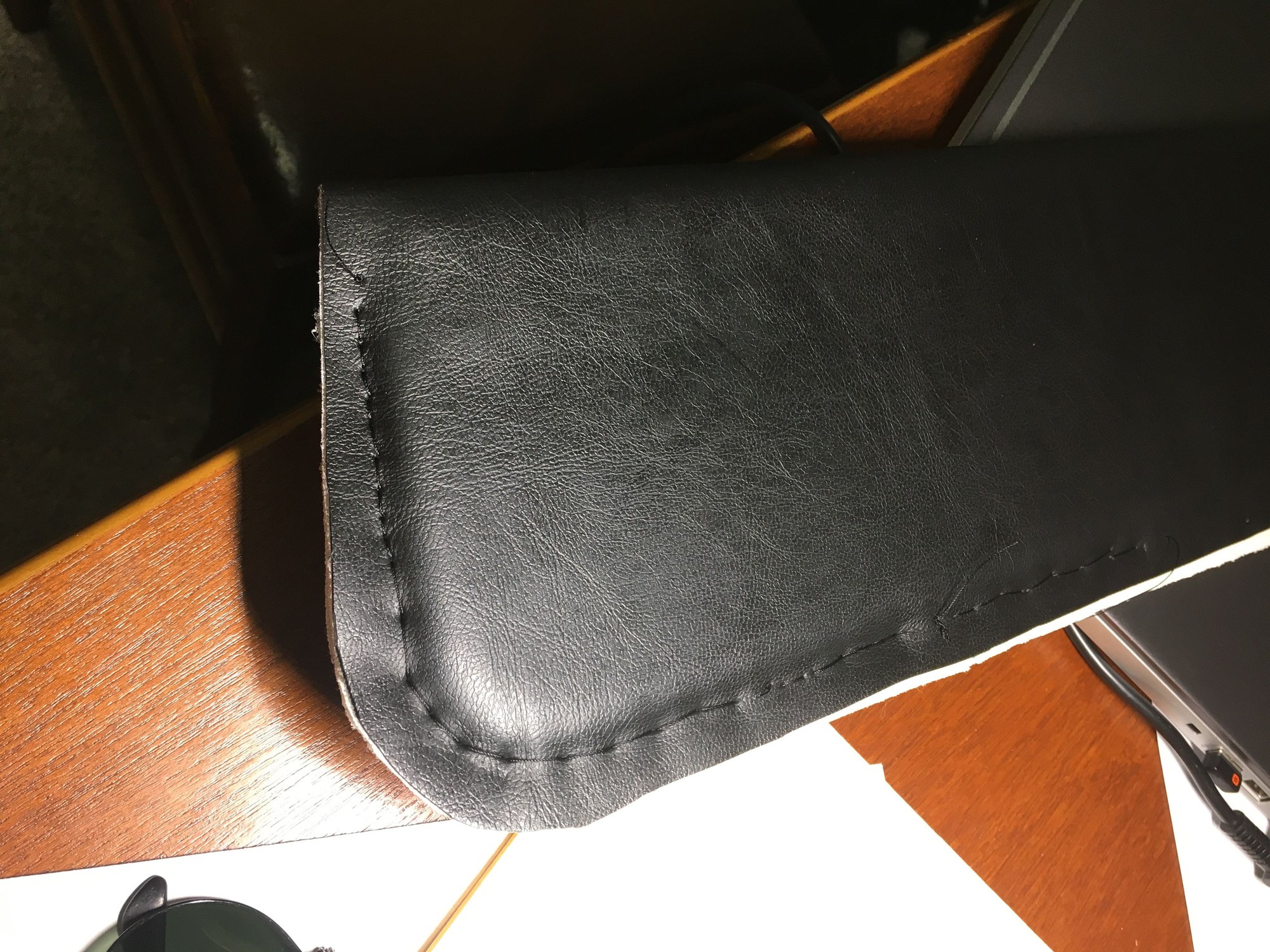

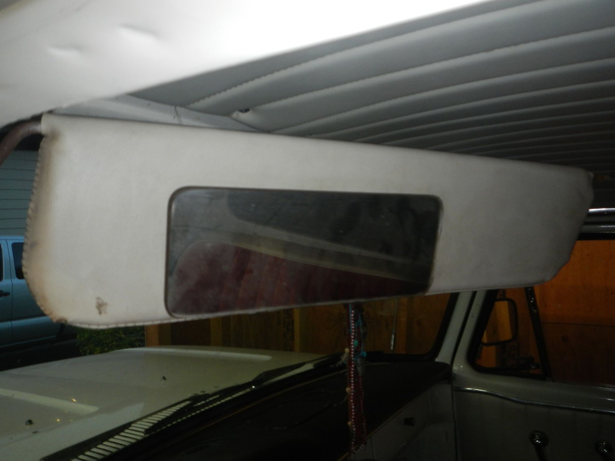

I made mine with a heavy grade vinyl. Only took a couple of hours. Little dirty but here they are.

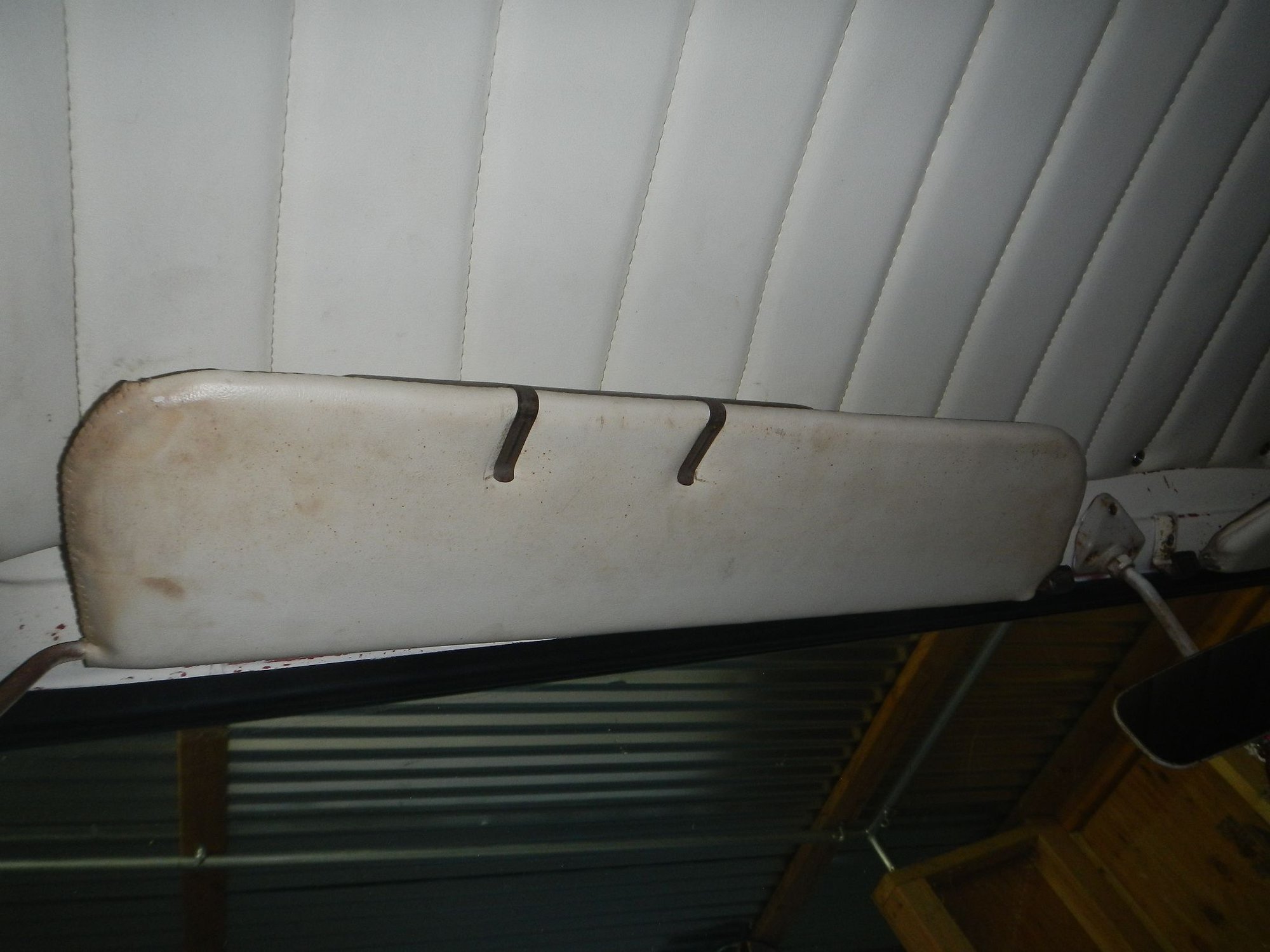

This is a set like I used.

That’s the state of mine currently.
with yours how did you sew the vinyl? Via machine or by hand?
Old Jul 31, 2020 | 11:26 PM
Christmas's Avatar
Christmas
Joined: Jun 2018
Posts: 3,553
Likes: 442
I used a machine to do the main part then turned it inside out slid it on then finished it off by hand. That took the longest. You can make that out in the pics. I also used quilting batting on the inside to give them some volume.

Here’s a snippet of what I have so far. I replaced the inner board, and am covering it in vinyl, then will be doing a stitch less binding around the
with vinyl adhesive
