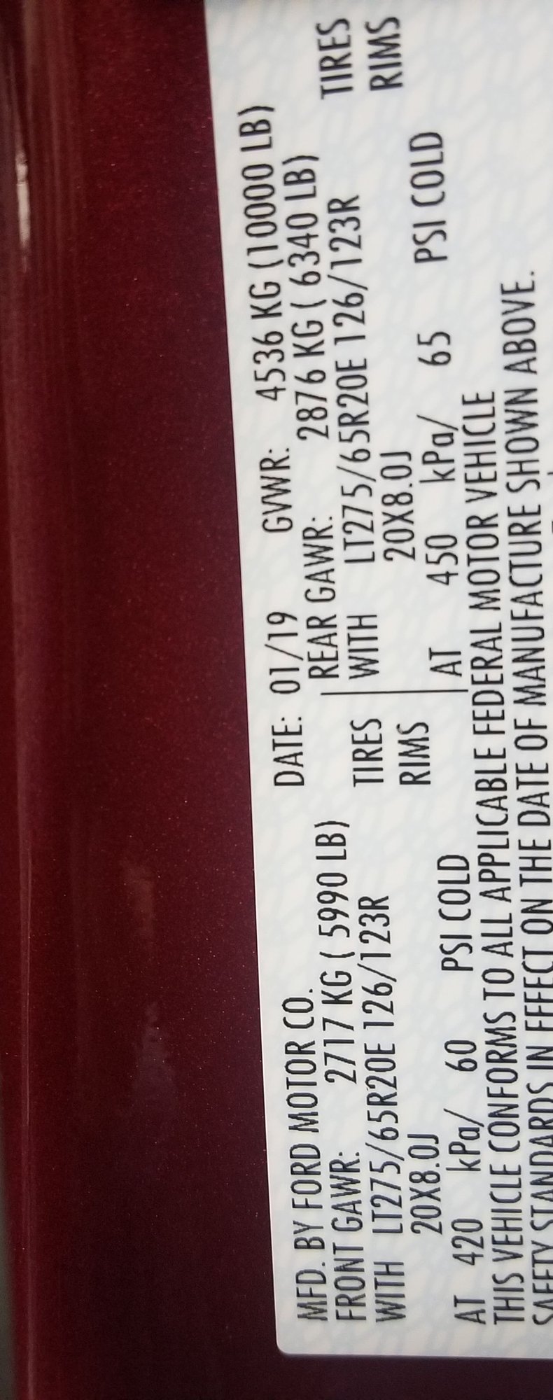

Drivers side door jamb, white sticker. Heres mine, with SP pkg. 5990 for front springs.
I believe non plow springs are around 4000.

Mattm400, interesting to compare tags...u have front GAWR of 5990 lbs, using 20 inch wheels, at 60 psi. Mine is 5600 GAWR, with 18 inch wheels at 70 psi. the back GAWR is spec'd w 80 psi. wondering why they limited my front GAWR to 70 psi in the tires...max is 80 psi on these tires. 80 psi would probably push it right up to 6000 lbs.

Hope you recover quickly! As you see, I do have the SP springs, it wasn't my choice but the truck was spec'd out almost exactly the way I would have ordered it. I don't mind the ride at all, I run around 60psi all the way around, I think it gives me the best feel and ride for this setup. Also as mentioned, the SP springs make the truck very close to level. I'm happy with mine although I've not been in one without the heavy springs to compair.
