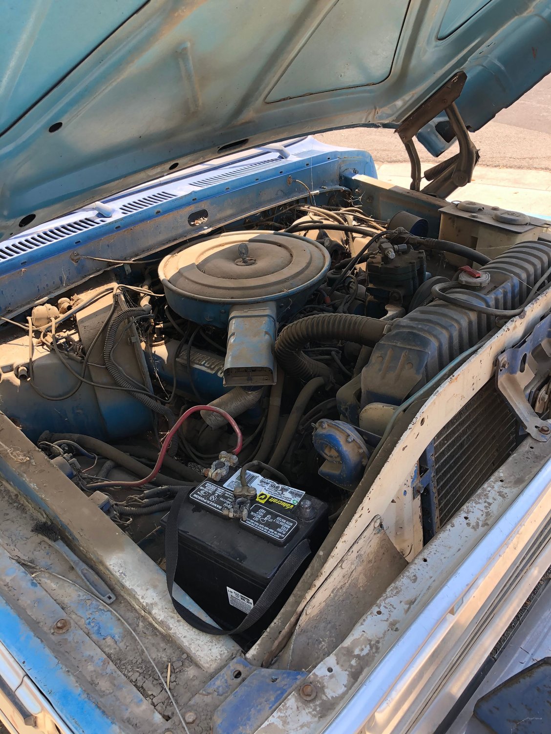

Hey there, this is my first post here. I just got a 73 f350 super camper special. I’m not sure what the engine size is though and neither is the seller.
I attached pics. Any tips on working on it? I got it for $1k in California. A mechanic buddy said it’s definitely worth the price. A couple grand into it and it will at least be running he said. Thanks!

Take a pic with the air cleaner off, a pic of a head where the spark plugs are, and a pic of the vin plate in the door jam (this will say what the original engine was).

the engine in the picture is either a 360 or 390...you would have to check to stroke to confirm which (without disassembling the engine)...but as previously mentioned, the VIN number will tell you what was originally installed at the factory.

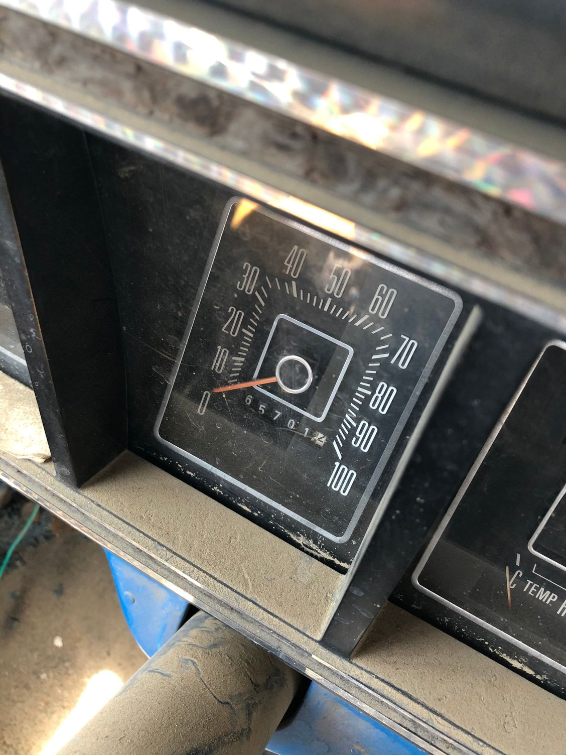

ok thanks! I can do that once it’s towed to my house. Do the stock motors on these hold up well? The odometer reads 65k miles.

I see. So it’s probably a small block I’m assuming? I haven’t seen/inspected under the hood yet completely.

A 360 or 390 would be a big block FE. I don't know about others, but mine has held up rather nicely. I was trying to see the spark plug pattern on the sides of the heads. That's how I always identify an FE, too dark in the pic. If I was you, I'd be pretty happy about an FE, but that's my taste. If you got this whole thing for $1,000 you are in great shape regardless. An FE will also have the head engineering number stamped there between the spark plugs. If you get that code someone could tell you what head you have.

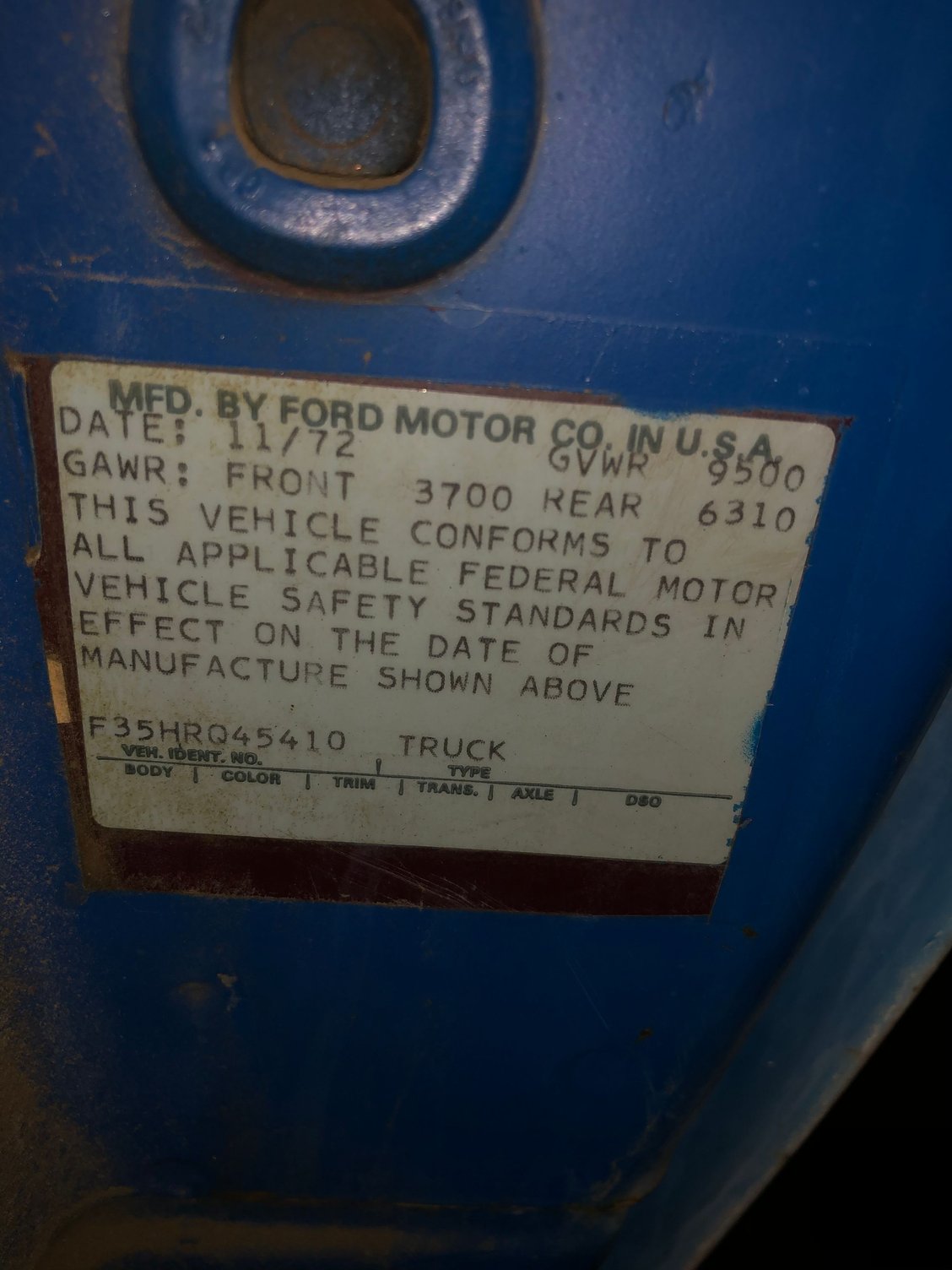

I finally got it home. Here’s the vin
Old Jul 28, 2020 | 11:56 PM
caravaggio2000's Avatar
caravaggio2000
Joined: Apr 2018
Posts: 1,244
Likes: 12
1973 H code: 390 FE
You're in luck if that's the original engine.

Well remember that 65k figure is on an odometer that only has 5 digits, so it could be 65k or 265k.

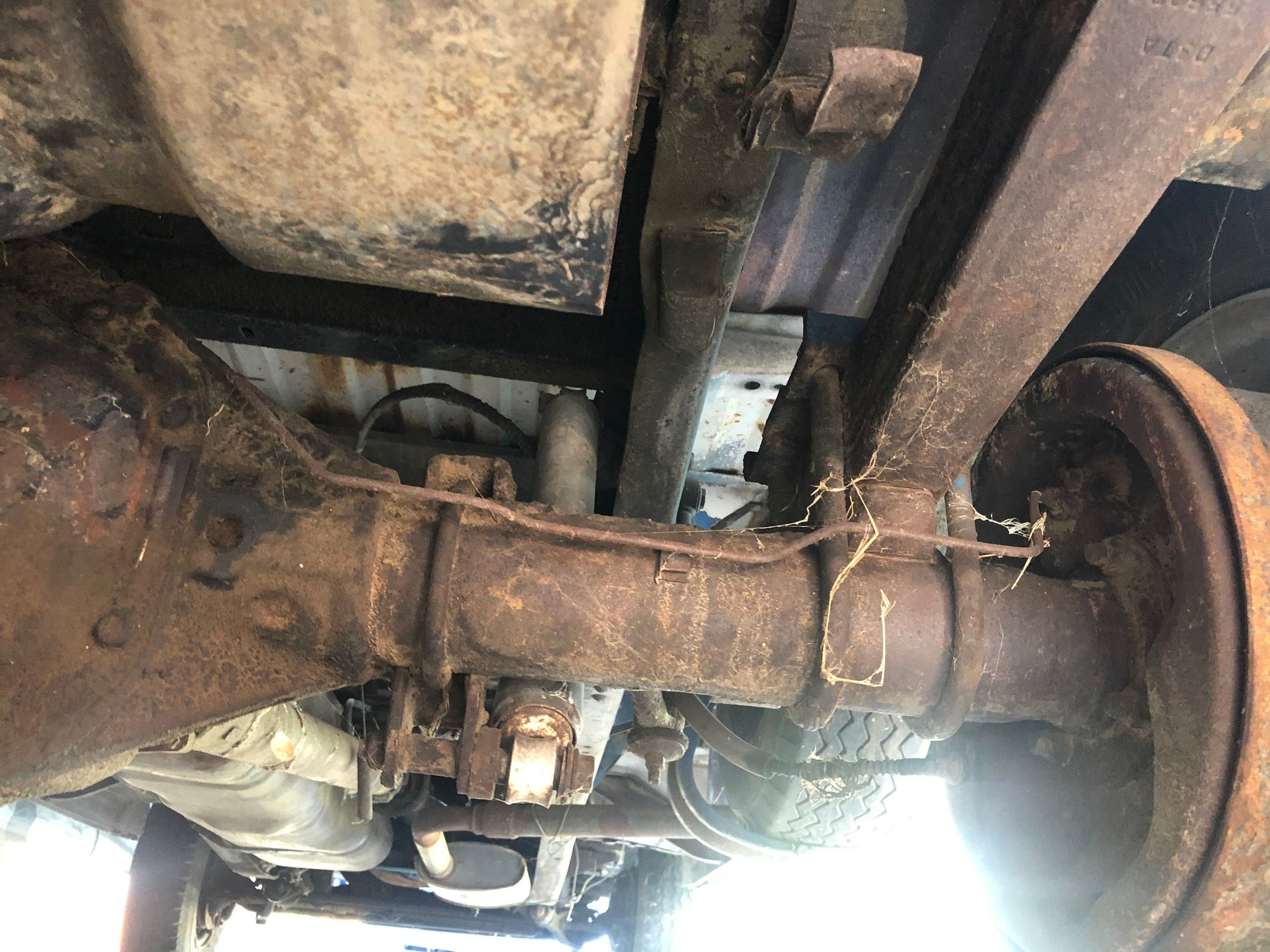

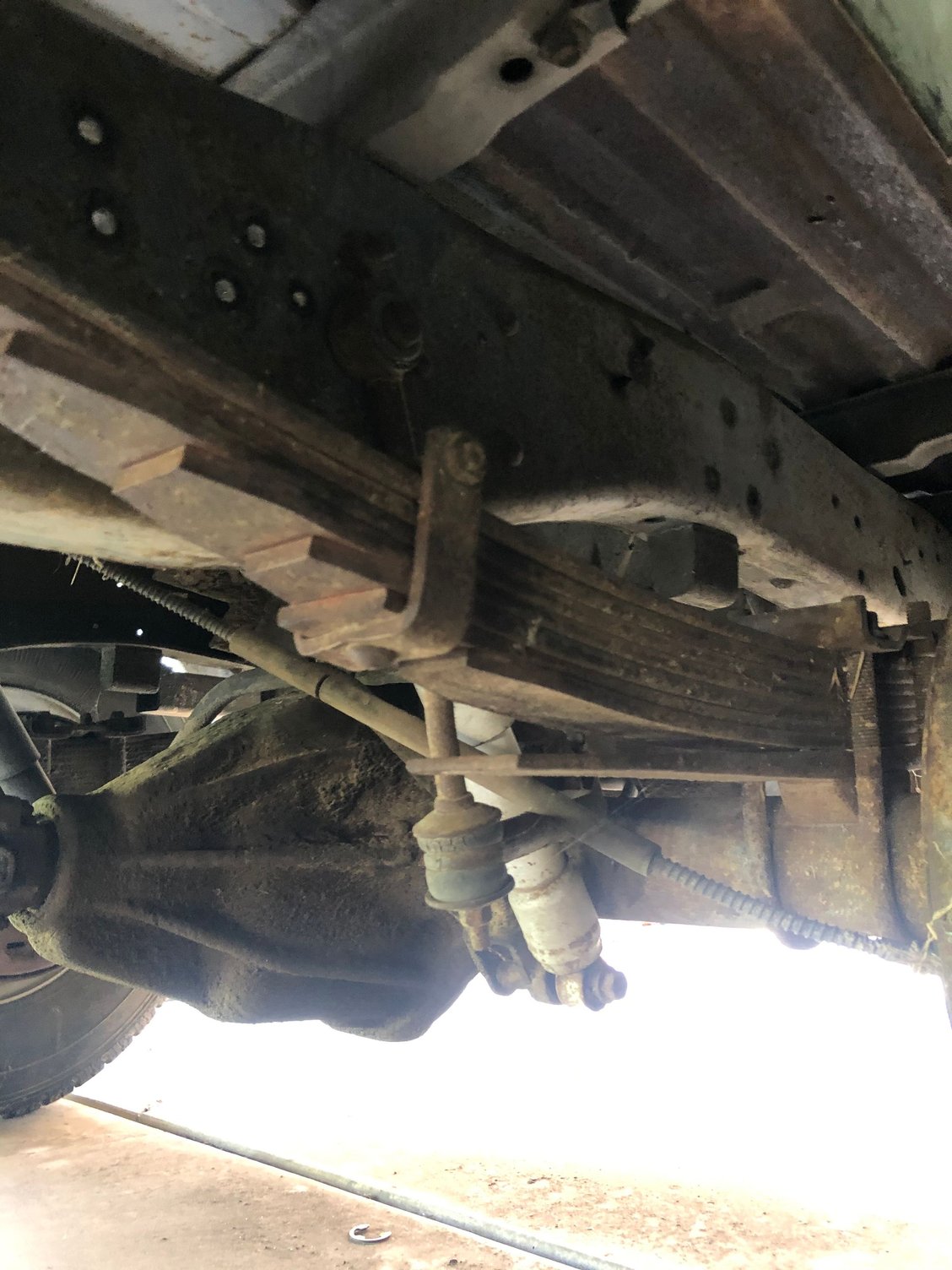

Let me ask you all:
So I did the “screwdriver test” on the heavily rusted parts, at least the ones I could reach for not having the truck up on jacks. It seemed surprisingly solid. I’m curious if you think this is TOO much rust? The drive train has it the worst I’d say. Are those easy to come across? I’m assuming the f250 long bed drivetrains will fit the fit the f350 SCS? Not sure the cross compatibility on parts. I was on the LMC truck website and they didn’t have a 1973 F350 option when selecting vehicle, they only had the f250.
