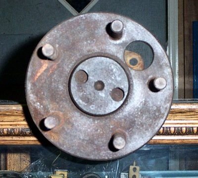

Would the Rear GAWR rating on the certification label clue us in?
I usually say that after all these years you need to pull the axle and count the splines yourself because you never know what some PO did.
Not sure I'd go by the end flanges either. That might hold true for certain year 9" rear ends, but the 28-spline axles in all the Early Broncos looked just like the 31-spline flange in the picture.

looks like most of the researh ive already done. not a resal clear answer. this is a rear end im buyimg and its about a hour and a half away. the only pics i got are of the end of the axle( looks like a 31, has the two holes not th big slot) and a partial pic of tag but i havent been able to find any of the info on how to use the tag to determine axle splines.

Only definitive way to know for sure is to pull a shaft. I pulled a 9" from a 78 Bronco in a salvage yard years ago that had the flanges that most said indicated 31 spline. Being 4x4 also should have been 31 spline. It wasn't. Didn't discover that till later. Maybe it had been swapped into that truck - no idea. But the 28 spline flanges had the holes just like 31's do.
