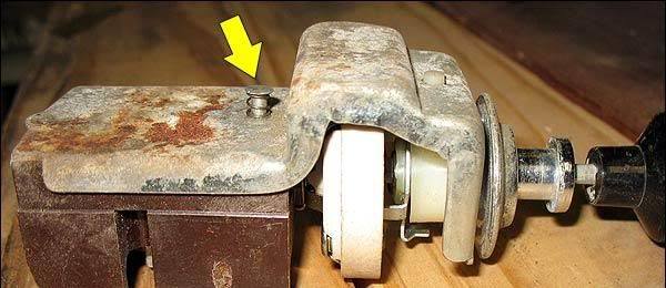

The Windshield wiper **** should just pull off. To get the **** out of the headlight switch, there is a button on the top of the enclosure you will have to press and pull the **** out at the same time. For the headlight switch, the entire shaft will come out with the ****. The button to press is the one furthest from the dashboard, you should be able to reach under the dash to get to it.

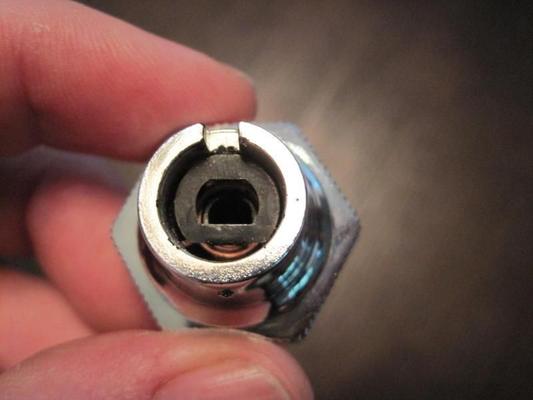

It's easy, but not obvious.
For the light switch, you'll need to reach up under the dash and feel around the actual switch until you find a button to push. Push the button and pull the ****, and it will come out with the shaft. You can poke it back in enough to turn off the lights, without it locking in place.
The wiper **** comes off by itself. There is a metal clip holding it. Stick a knife or flat screw driver behind the **** and pull it toward you and the **** will come right off. You might need to try on top of the shaft, below the shaft, and to the left and right of the shaft till you find the right part of the clip. Only one side of the the clip will release the ****.
This kind of shows the clip. You want to press the D-shaped part into the **** to release it. It doesn't look like it from the picture, but a knife or flat screw driver behind the **** should be able to push it back enough to release it. From the looks of the **** in the picture, you would need a pick or pointed object to stick into that slot, to contact the clip.
