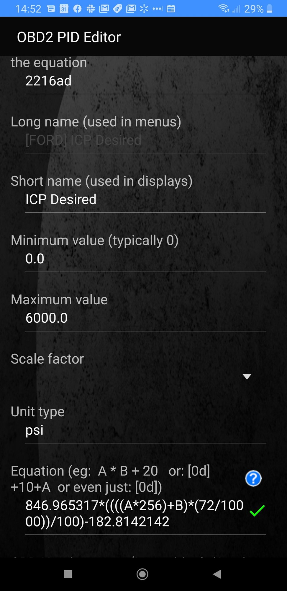

It's not that straight forward. Those numbers don't mean anything without context. What you need to look at is the ICP voltage. With that voltage you can calculate the desired HPOP pressure. Once you have that you can compare your actual HPOP pressure values to the desired value.
It's been a while, I will see if I can find the equations for torque pro. The desired ICP equation for torque pro isn't great because it's a line of best fit equation. It can be pretty inaccurate. You might be better off logging some ICP voltages and HPOP pressures and look at the Ford chart.
(Edit: added equation)
Here is what I have, I don't remember whose equation it is, I had been messing around in MATLAB looking for a better fitting equation. I don't remember what if I ended up using mine or someone else's.
