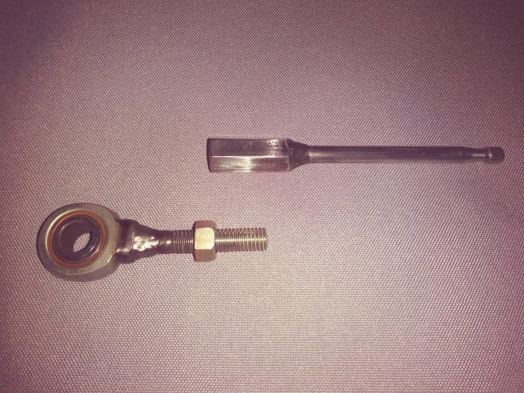

Everyone has a tipping point. Perhaps it was a lazy leg, perfectionism to the max, or paranoia of syncros grinding away. Being accustomed to only depressing the clutch pedal a couple inches for full disengagement in my other vehicle, it seemed impossible to retrain the left leg to slam the pedal all the way down to the floor for a full 100% clutch disengagement. It was time to do something. Here is the result, and thus far, I'm pleased.
Push rod removal tool.
It would have been better to use a virgin heim joint with a 10 mm hole and threads, but this was done in steps - modified, revised, modified, revised ect. so the end product is an imperfect part for an imperfect truck. Hopefully this doesn't overextend the clutch fingers, but full disengagement is at 75-80% down on the pedal rather than 90-95%
No clutch switch now, just a double throw toggle on the dash. Never was a fan anyway.

Nice work. I adjusted the clutch to do the same thing in a car I used for track duty. Then I installed a clutch stop (basically an adjustable door stop for the clutch pedal)such that maximum possible travel of the clutch pedal was only one inch from fully released to fully depressed.

If you made the rod longer, you just moved the resting pedal further from the floor. The travel required to disengage clutch did not change.

The clutch master cylinder dictates the upper limit. Longer rod moves pedal further from floor.

My ideal fix would be a larger diameter master cylinder to achieve a shorter pedal travel - or a different clutch. But this is the easy remedy, so yes the only thing that changed was the distance the pedal sits from the floor. At rest, the pedal sits noticeably higher than the brake now, but the throw matches my leg, which is the important part. This same problem existed on the last clutch, and the last E99 truck. I have a lazy leg, not much else to say...
