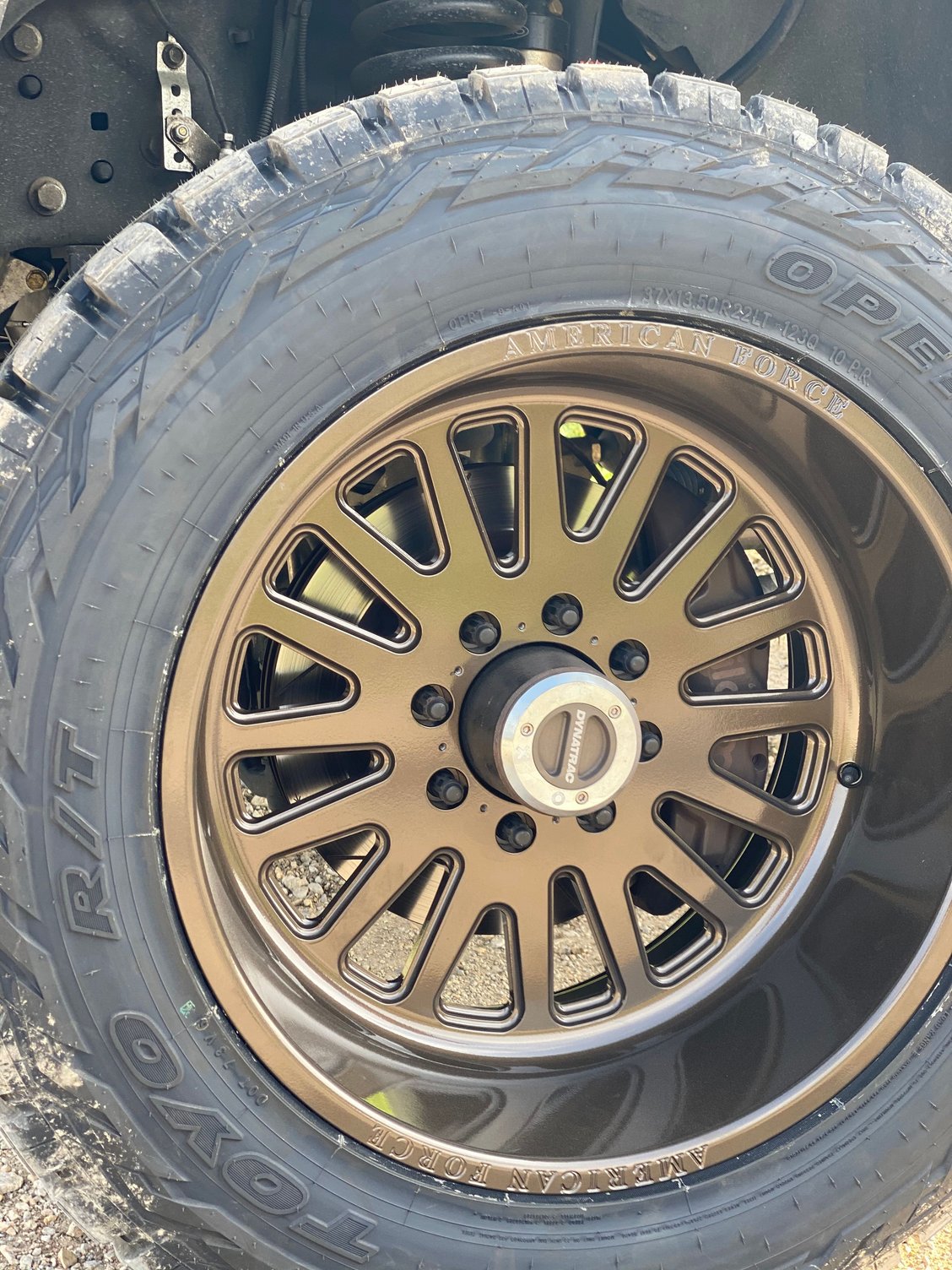

Does any aftermarket manufacturers off front locking diff for our Dana 60’s? I already switched out my hubs with dynatrac free spinning hubs which I highly recommend if anyone is interested. But I would like a true 4wd truck versus what what we have now which is a 3wd truck. Thanks PFA

Why would you highly recommend doing that? They have locking hubs to begin with, the only thing you are gaining is getting spindle bearings instead of unit bearings, but the unit bearings are long lasting and pretty easy to change if they do fail.

have you compared the parts side by side. The ford parts look like garbage compared to the dynatacs.

I think the 05+ unit bearings are very high quality. I have 300,000+ miles on the 2006 F-250 and original bearings. The tapered bearing size is much larger than the Dynatracs and they are hermetically sealed, so there's less maintenance that inherently comes with full floating spindles.
Dynatracs are great if you own a Ram product or want to upgrade the 99-2004 Super Duty, but in this poster's opinion, superfluous based on the current SD running gear.
