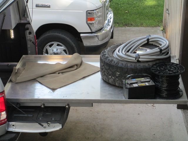

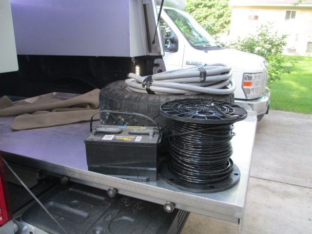

Steve,
Top of bedslide is 4.25 inches above the bed. Frame of the bedslide is 5 inches above the bed.

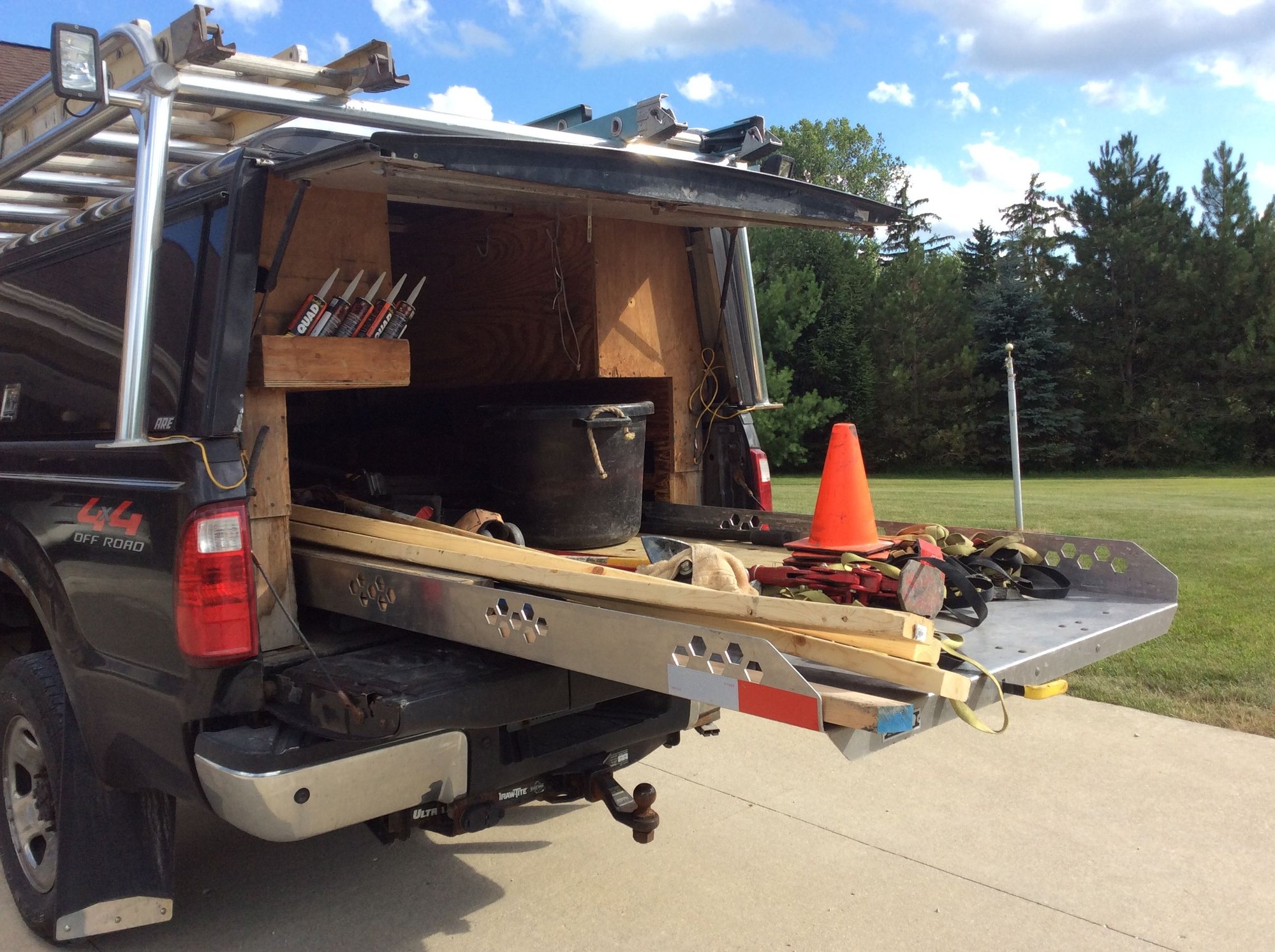

from bed tailgate floor to floor of the cargo glide is 6 3/4”. From garage floor to Floor of cargo glide is 44.5”. It is a ways up there, but I have the heavy duty version, rated at 2200 lbs at full extension. I have had 2000lbs plus in the bed and it handled it with ease, I pulled it out, guys on forklift slung 20 100lb bags of materials into the entire bed while at full extension and they were standing on slide while loading, they were initially worried, then amazed. I wasn’t, not even a shrug from unit, It impressed guys at the co-op big time. Loaded unit slid into cargo area smoothly. Just make sure you are on level ground if fully loaded! Ha!
heavy duty unit comes with high sides that are strong and can contain shifting materials and bags of concrete etc.
on my 96 dodge, I have the 1500 lighter unit, and it is only 4.25” high from bed, It opens to about the wheel well area. Also, had 1200 lbs in this unit, wish I had heavy duty unit, it is that much more sturdy. But it handled the 1200 lbs just fine.
I am a huge fan of the full extension XL2200. I am 60, 5’10” and full 5-6 gallon buckets of chains, and liquids are still doable for this old fat dude
this photo below I have a ladder, two coolers, three big suitcases, plus action packer with emergency gear, recovery equipment, full size shovel, hi lift jack, 5 gallon bucket of stuff, several boxes and it is only pulled out about 50% because of room on the carport at my parents. Note, the 6.5’ 2200XL weighs over 300 lbs, coupled with the rating of 2200Lbs , the slide is capable of handling 2500lbs including weight of the unit.

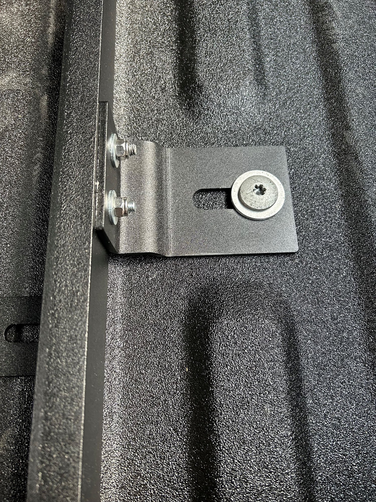

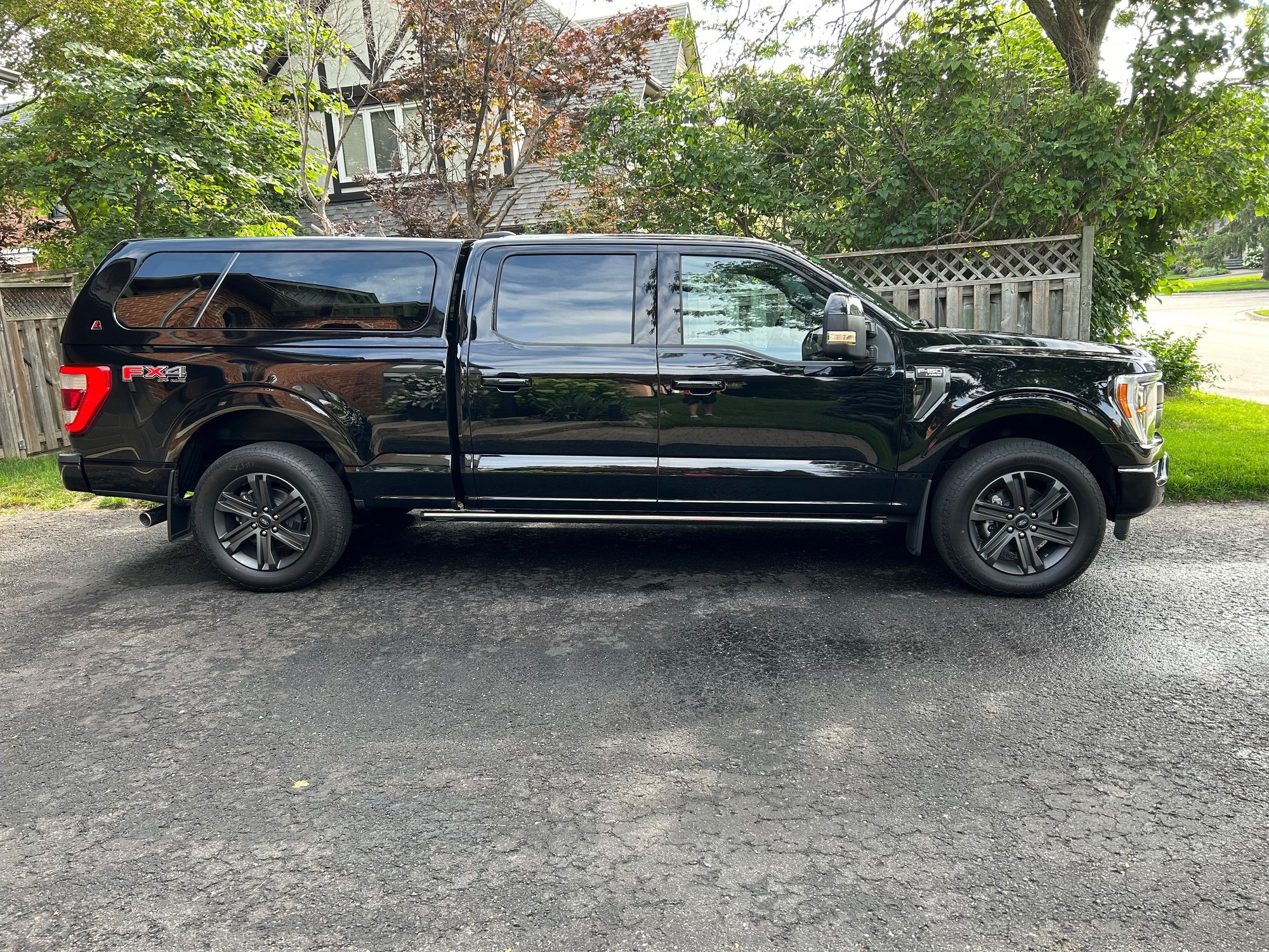

I installed a Bedslide (by LEER) & added the no drill kit, also added a LEER Cap 100XL
I would highly recommend Bedslide with the "no drill kit"
I had a Cargo-ease in my Tacoma and i found it a bit clunky. Mind you it was purchased 4 years ago and maybe they have improved.
