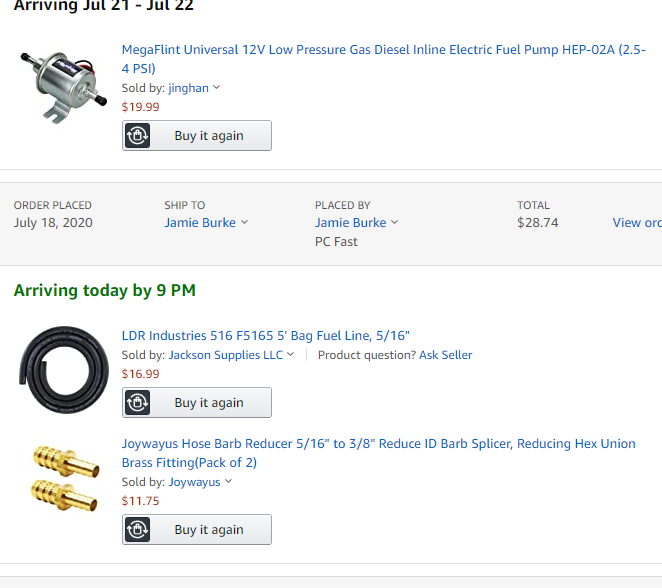

Nm, scratch this. I'm just going to carry a small 5psi pump, hoses. Don't want this to happen while I'm 100miles from other humans

Yeah I ordered a kit just to keep with me.
I'll set it up, then remove it and pack it.
