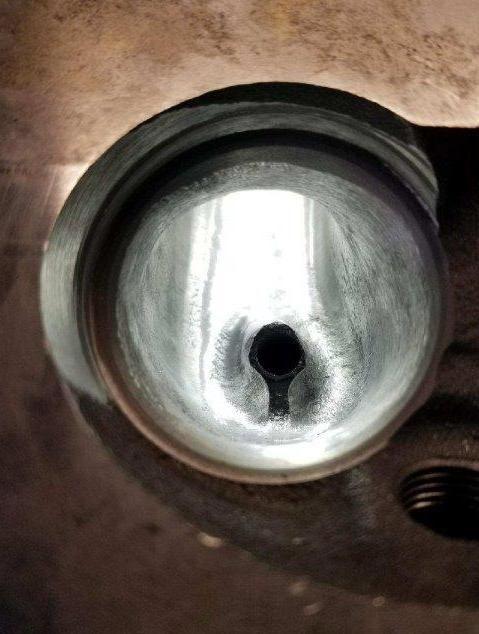

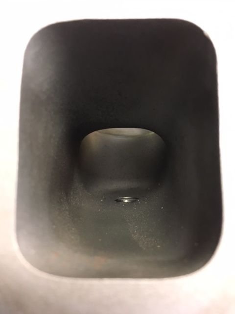

Here is some port work that another forum member just finished.
The seats for the larger valves have not been cut yet.
After the larger seats are cut you carefully blend the 60 degree throat angle below the seat into the bowl walls.
Exhaust:
https://i.imgur.com/GRyO9Qt.jpg
https://i.imgur.com/vMMWswc.jpg
Intake:
https://i.imgur.com/09Wb0TP.jpg
https://i.imgur.com/XH0wBkr.jpg

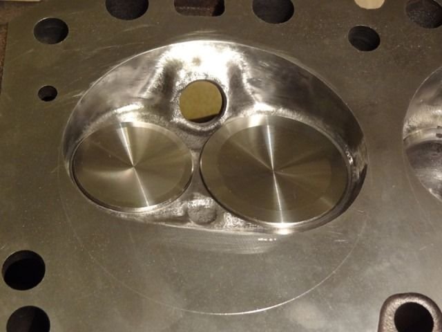

I like to unshroud the combustion chamber by installing the head on a bare block and scribing the cylinder bore on the head surface.
Then grind the chamber walls around the spark plug out to the scribe lines.
Shown below is a chamber with 2.02"/1.60" Chevy valves.
