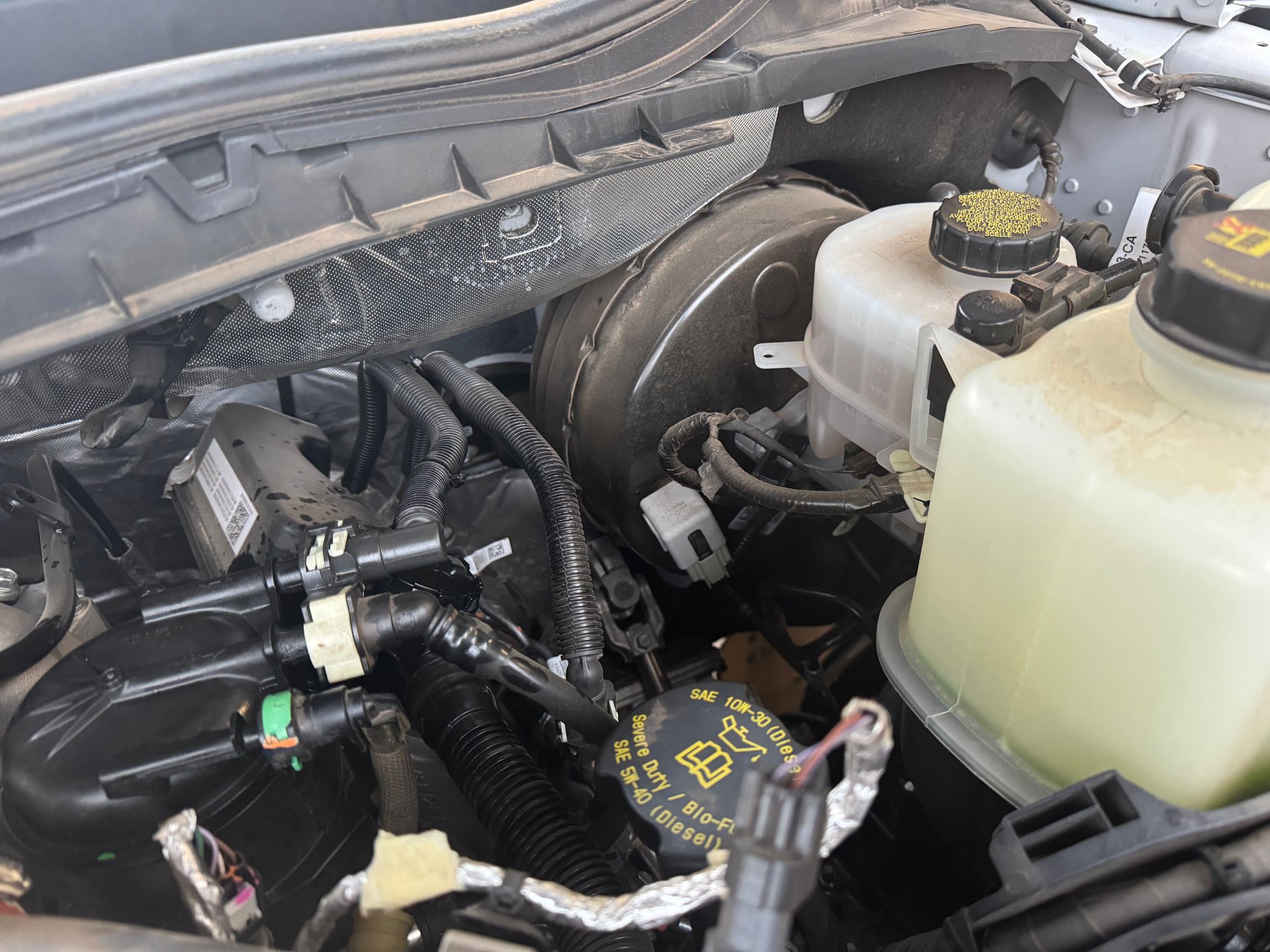

To bump the thread, I have a 2024 F350 6.7 HO with 12,0000# gvwr and I Have what looks like the vac-boost? I thought with my gvwr, I should have hydro-boost? Did the look change on the 23+ trucks or do I indeed have the vac boost?
Old Dec 21, 2024 | 11:23 PM
  #45
Sport45's Avatar
Sport45
Joined: Apr 2003
Posts: 2,058
Likes: 424
From: Too close to Houston
Looks like the vacuum booster on my truck. Don’t worry though, you’ll be able to stop just fine.
