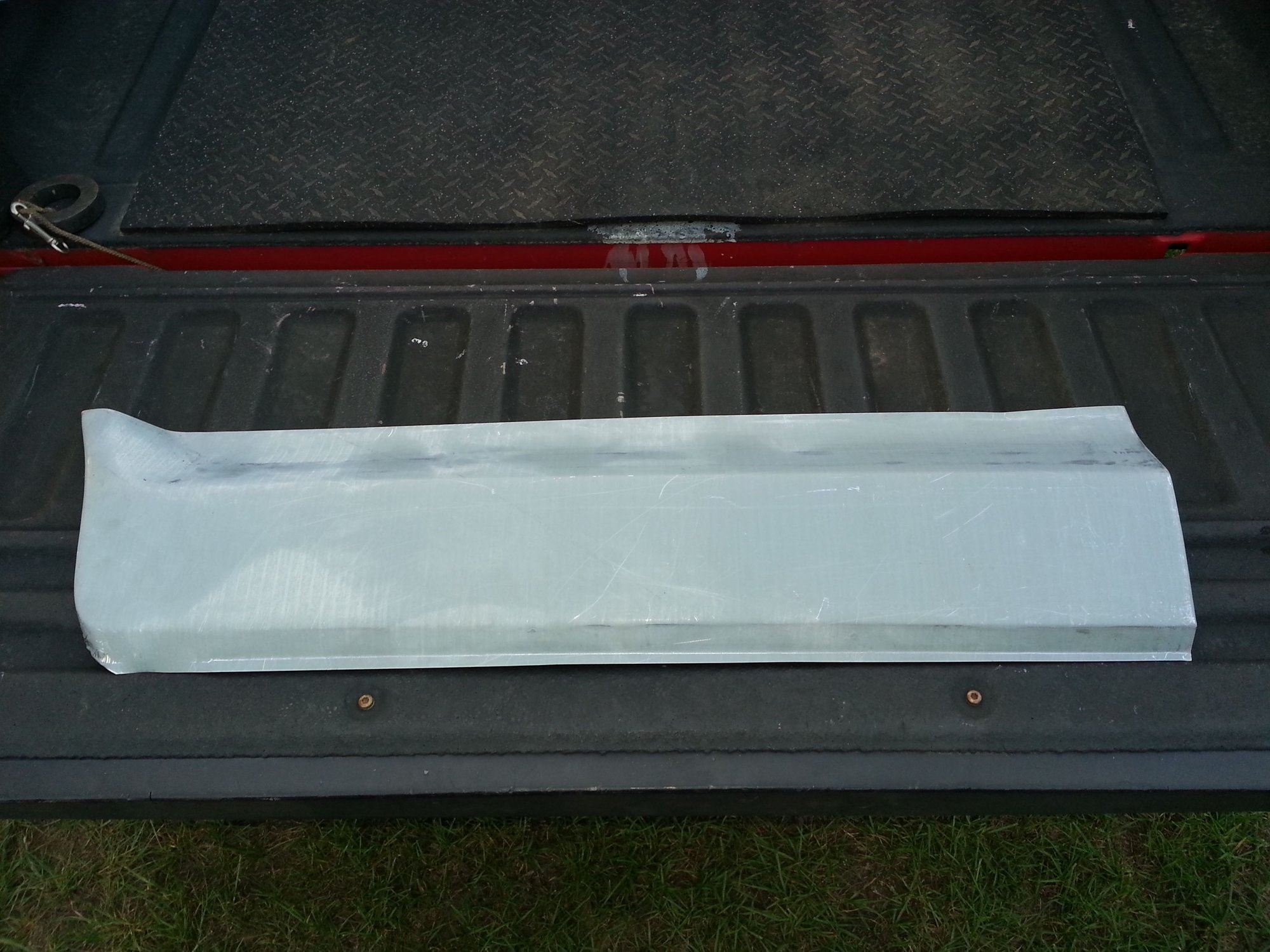

It is impossible to find a short bed box around here, so my son and I got one of these from Summit for 129.99 + tax and FREE shipping. I can only find the RH side, so we are going to see if it will work to flip it upside down and use 2 RH sides when it gets cool enough outside to cut it down for a short bed. See if Summit has the pieces you need to piece together your bed and hopefully still get free shipping. I know patch panels are available from several suppliers, but this was the best deal out there on bed floors.
We also have these for the bed sides when we start on the bed. (this Fall hopefully)
