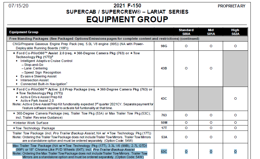

They also for 21 made it so you can't get max tow on anything above XLT 301a. The max tow now requires the HD payload package. The HD payload is restricted to 301a and below. So effectively they took away max tow from all but a few trucks.

im not getting that from guide shared. Appears you can only get heavy duty payload on 301a or below. Seeing max tow available on 302a and lariats. Stopped looking at that point.

As i read it max tow requires HDPP only on xl.

I'm reading it differently as well, looks like Max Tow is available in all trims. THANKS for posting the order guide, I will add this to an information sticky at the top of the forum when I have a few more things to post.

You are right, I didn't read carefully enough. So max tow is available on all trims but requires HDPP on XL. So I wonder what that means for STX package XL trucks?

I am attempting to determine the difference between normal tow package and max tow package. I would get a Lariat high package hybrid truck with sport package and 20" wheels. When I build it I can only see a bumper upgrade as the axle ratio and all other options are determined due other packages.
Is there a brake upgrade or anything with the max package over the normal tow package? I am looking at about a $200 difference with X plan pricing between the two packages.

I don't see anything in the order guide about a brake upgrade, the packages are pretty similar. In previous years the "bumper upgrade" really meant an upgraded hitch. The difference wasn't huge though, so unless year planning on pushing the limits it might not be worthwhile.
Originally Posted by 2021 F150 Order Guide
MAX TRAILER TOW PACKAGE (53C)
Usage: Max towing capability TBD.
Availability:
•Optional on XL, XLT, Lariat, King Ranch® and Platinum
Not available with:
•17" silver steel (64C)
•17" silver painted aluminum wheels (64F)
•18” chrome-like PVD wheels (64T)
•2.7L GTDI Engine (99P)
•3.3L V6 Engine (99B)
Requires:
•3.5L EcoBoost® Engine (998)
•5.0L V8 Engine (995)
•3.5L PowerBoost Full Hybrid V6 Engine (99D)
•3.0L Diesel Engine (991)
•Heavy-Duty Payload Package (627) on XL
Includes:
•3.55 Electronic-locking rear-axle (axle is changed to 3.73 Electronic-locking differential if ordered with Heavy-Duty Payload Pkg. (627))
•7-pin wiring harness; includes 7-pin-to-4-pin adapter
•36 Gallon Fuel tank (NA w/ 3.5L PowerBoost Full Hybrid V6 (99D) or 3.0L Diesel engine (991))
•Class IV trailer hitch receiver
•Pro Trailer Backup Assist (Not included on XL)
•Pro Trailer Backup Assist – NA on XL (100A only); reqs. Tow Technology on XL (101A only)
•Smart Trailer Tow Connector (incl. BLIS® w/ Trailer Tow Coverage where is BLIS®available)
•Integrated Trailer Brake Controller
•Upgraded rear bumper
Optional Equipment
•Ford Co-Pilot360™ 2.0 on XL (101A) (43A)
•Tow Technology Package (17T) (101A)
NOTE: Ordering the Max Trailer Tow Package does not include Trailer Tow Mirrors. TrailerTow Mirrors are a standalone option and must be ordered separately.
