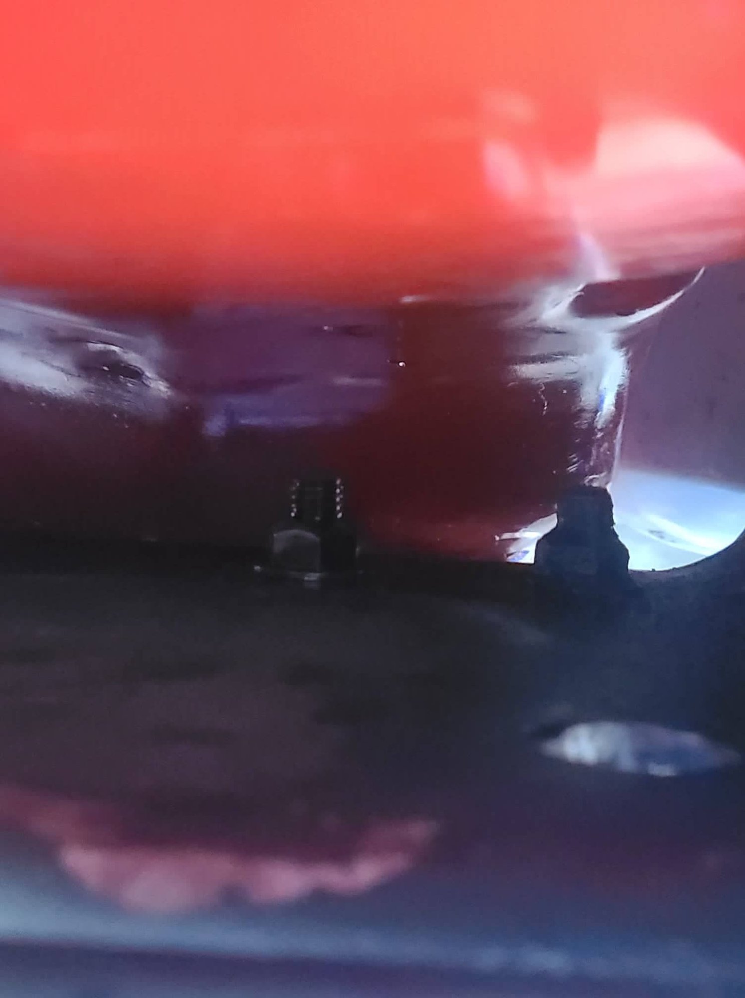

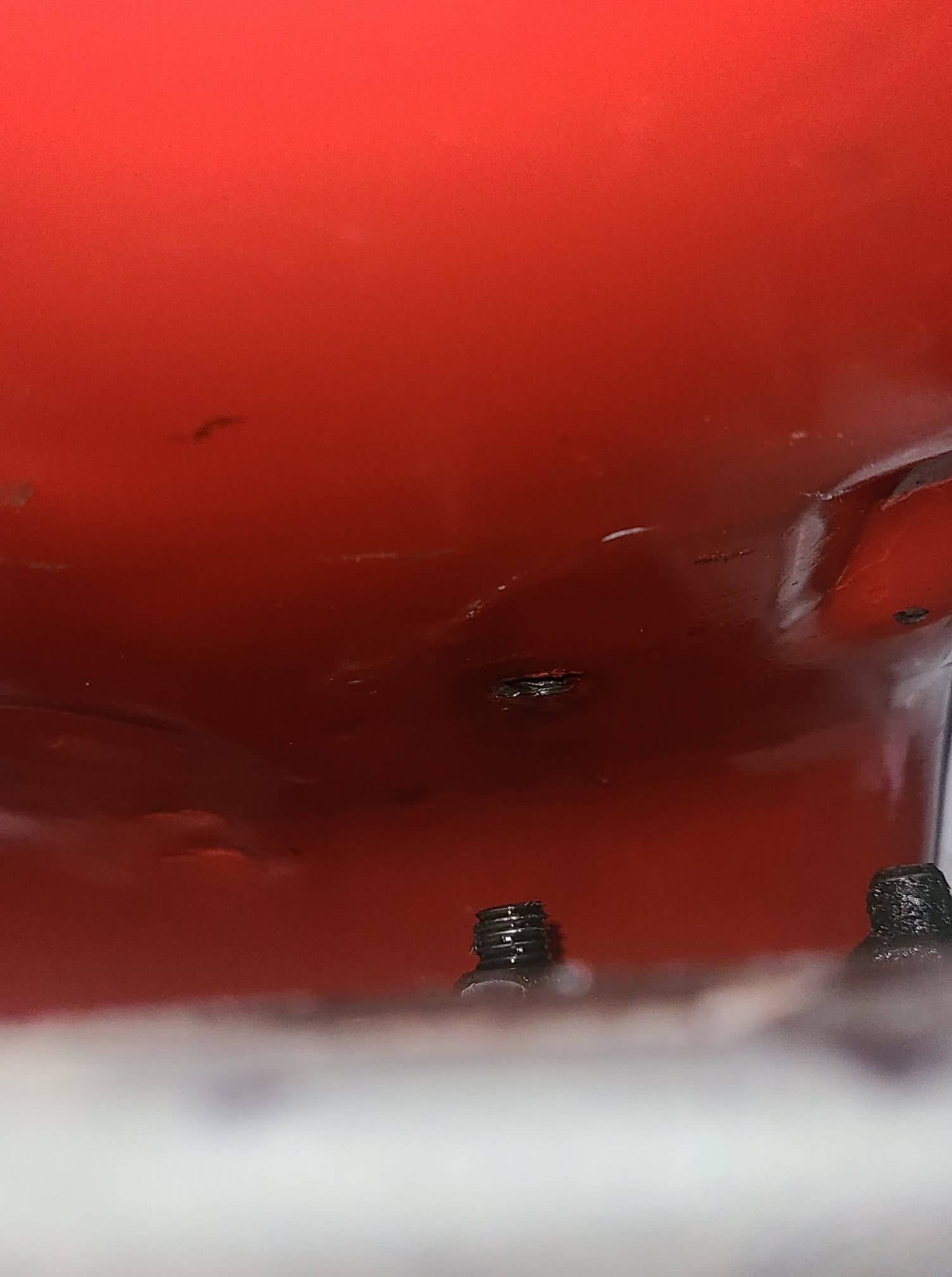

It ended up being the new oil pan gasket was ever so slightly too big, which pushed a bolt from the TTB into the bottom of the pan....... I now have to find a way to fix this hole on the pan. I really hope I don't have to pull the motor again.............
Does anyone have any advice on how to go about fixing it? I'd REALLY rather not pull the motor all over again. If I have to, then I suppose it is what it is, but I'd rather try some other fixes first. Maybe they make nylon wedges I can shove up there with RTV, and have it press itself into place? Or maybe I can lift the motor high enough to tap a plug into that spot, and get a shorter bolt and nut that is sticking up in the first place.
Edit: I did some reading, maybe I can get enough clearence to clean that area okay, then slap some JB weld on it? I'd have to still get a shorter bolt and nut from the TTB, but apparently people have had decent success with JB weld.

maybe loosen the engine mounts and dent the oil pan and fix with JB weld or FoMoCo TA-31 sealant?

That's what I'm going to try and attempt! I got back from leave this Sunday, and I was busy all this week, but I took two more weeks of leave so I can get this house ready for sale and fix my truck! I tried lifting the motor up today with my hoist..... the hoist ended up failing on me. The frame that holds the boom cracked before it lifted the motor. I over abused that 1 ton harbor freight hoist by over extending the boom on way too many occasions so I'm actually very impressed with how long it help up. It was a great hoist, but now I have to get a different (preferably longer boom and heavier duty) hoist.

As for the hole, I managed to jack the engine up enough without unbolting the transmission, I just had to take off the downpipe. I believe I should be able to patch the hole with either JB weld, Motorcraft RTV, or (what I'm going to attempt first) a universal oil pan plug with RTV around the edge.
I just have to reverse the one bolt coming up through the TTB axle so the bolt head is on top and the excess threads are sticking down... I don't know why I didn't do that when putting it back in. I physically held it before and said it may be an issue, but when I went to put it back in I just figured I'd put it in the way it came out.... oh well!

For the patch I tried, the universal plug wouldn't sit level on the hole. https://shop.advanceautoparts.com/p/...E&gclsrc=aw.ds I cut down the thread quite a bit, then cut down the arm that grabs on the inside of the oil pan. I barely had enough clearance to get the plug in there, but I did, and it started grabbing. I believe the oil pan baffle was in the way for the thread to sit straight up and down however. I couldn't tell if the plug sealed all around the hole (because it was tightening down at an angle due to the thread hitting the baffle inside the pan), so I globbed a ton of the Motorcraft RTV (which I bought for the oil pan in the first place before buying the one piece gasket). It looked fully sealed, but I have yet to try it.
When I lowered the motor down, the plug is getting squished up against the pan, so maybe the tight clearance in this situation will help me by keeping that plug wedged against the pan until the next time I have to pull the motor. My batteries keep dying, I think it was due to the corrosion on my old fuel sending unit, which randomly turned the fuel pump on even when the truck was off. My batteries are still under warranty, but I have to keep charging them before starting the truck!
I'll find out after my wife and I get some food if the plug situation is holding! It's definitely not the most ideal situation, but if it lasts me a year or two, I'll have enough time to settle back home and have a garage where I can work on it and not worry about moving!

So I got a chance to drive it today and it seems like the patch I did is holding up. I feel like it should be good until I need to pull the motor again! No more coolant leaks, and no more oil leaks! It's nice to not have to worry about anything leaking anymore.
