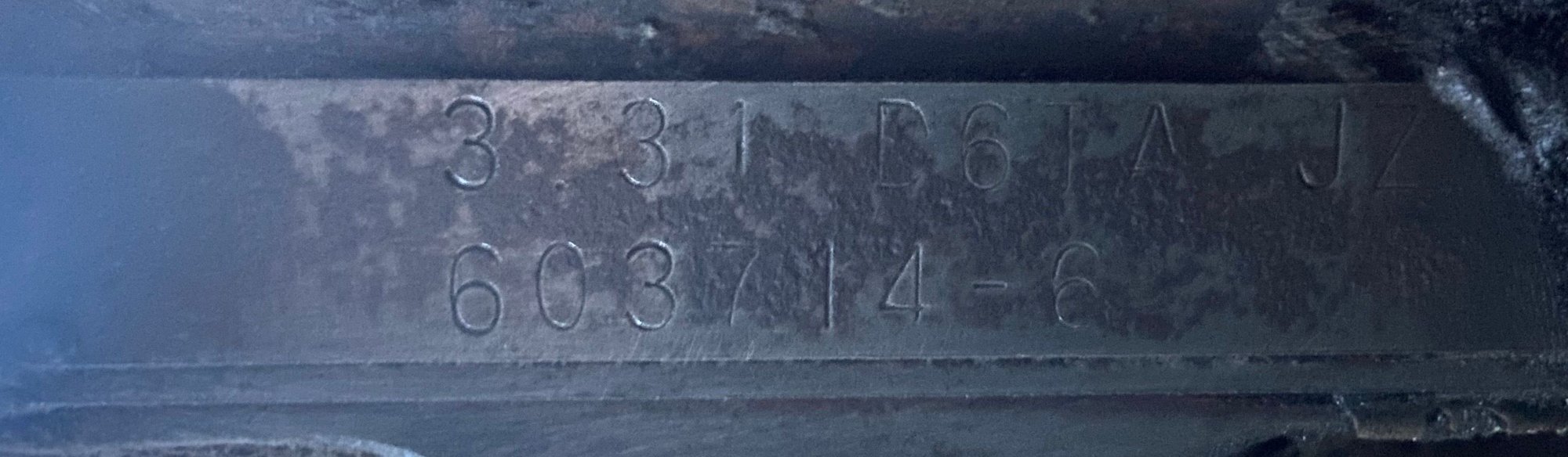

Can someone decode this d60
tag or tell me where I can. I can’t remember.
looks like.
3 31 d6ta jz 603714-6
also, 3 31 gears, why would it have that? I’ve seen 3.50 and 3.73, but never 3.31.

Is it a 2wd truck? If so that 3.31 might be more common even in a D60.
The key number in the old days was the BOM (bill-of-materials) which is that 603714-6 number. Even though not complete, the Dana website does let you search some BOM numbers.
There are other sites as well, but I don't have any of them saved. A guy named MrN used to have some good stuff, but not sure if the pages are still up after all these years or if you have to hunt through the internet archives for that.
Good luck. Pretty sure there are members here that know this stuff too, so with luck someone will chime in before you have to hunt the great recesses of the internet universe.

It is most likely a dana 61 https://en.wikipedia.org/wiki/Dana_60 scroll down to 61 toward the bottom or check the dana 60 bible BillaVista.com-Dana 60 Front Axle Bible Tech Article by BillaVista

Originally Posted by brian1080
Can someone decode this d60 tag or tell me where I can. I can’t remember.
looks like. 3 31 D6TA-JZ 603714-6
Has to be D6TA-JZA because there's no such code as D6TA-JZ
Dana 61-1 or 61-2 Rear Axle / 3.31-1 // No Limited Slip // 5,300 lbs. Rear Axle Capacity // 1973/79 F250.
