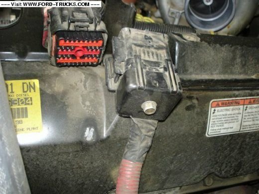

Also could be wires from the 42 pin harness chaffing on the driver's side valve cover and shorting/grounding briefly. I have had those same 3 lights come on when this happened to me. I could repeat the issue by putting the truck in reverse and giving it a little pedal. Engine would rock the valve cover into the harness, sometimes killing the engine. Would start right back up.

This ^ along with a dozen other probable chaffing discrepancies need to be addressed and inspected. There are many points along the harness where the engineers must have drawn up their **** poor blueprint on a friday afternoon. With a bag of Adel clamps, conduit, wire ties, and good grade electrical tape you can finish the work they started and increase your reliability by a long shot. Look at the reliable methods used in the aviation industry as an example. One of my biggest pet peeves with these trucks is having a hose or wire bundle in plastic conduit laying on an aluminum intercooler pipe. Did they really design it that way?
