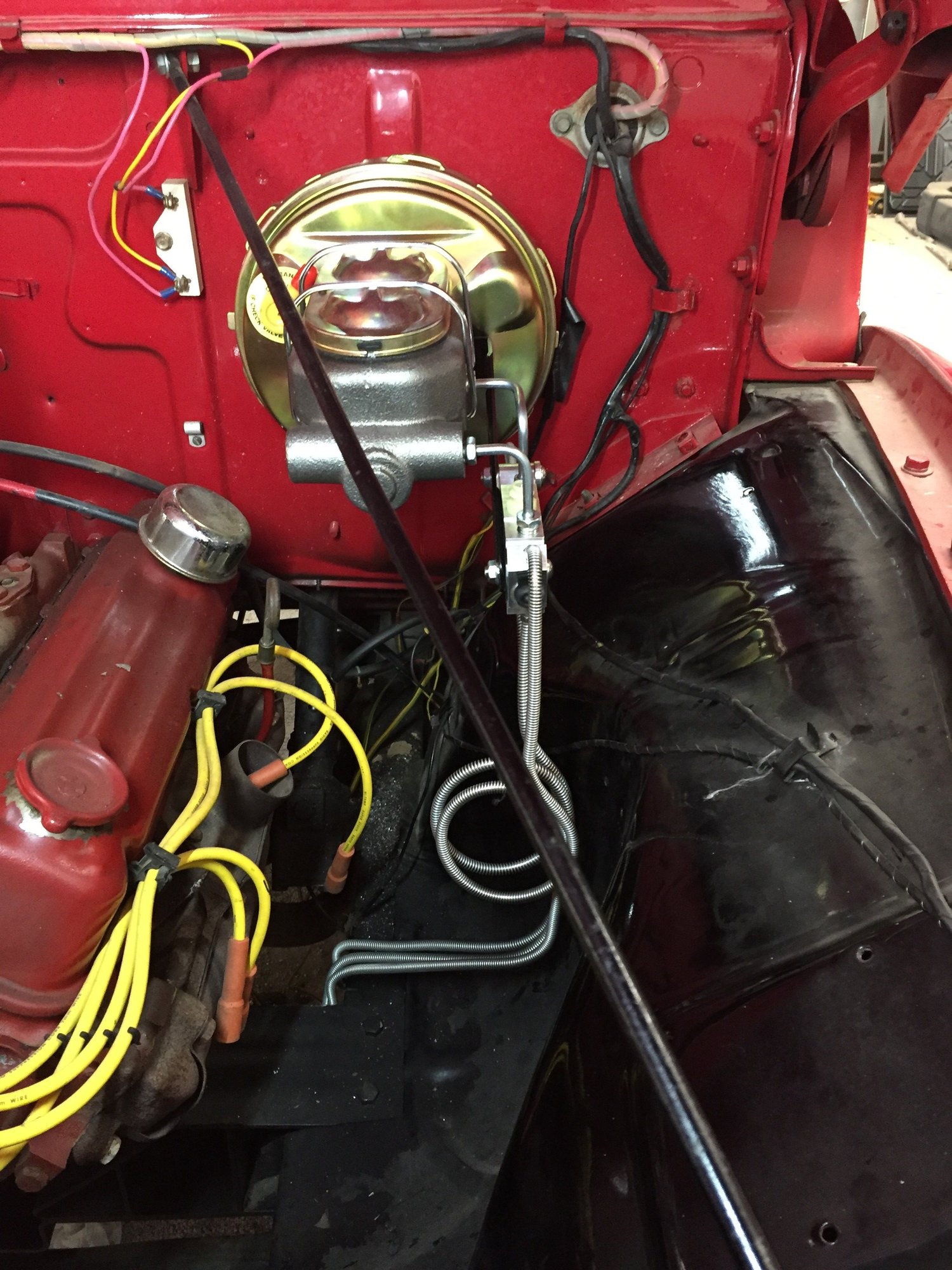

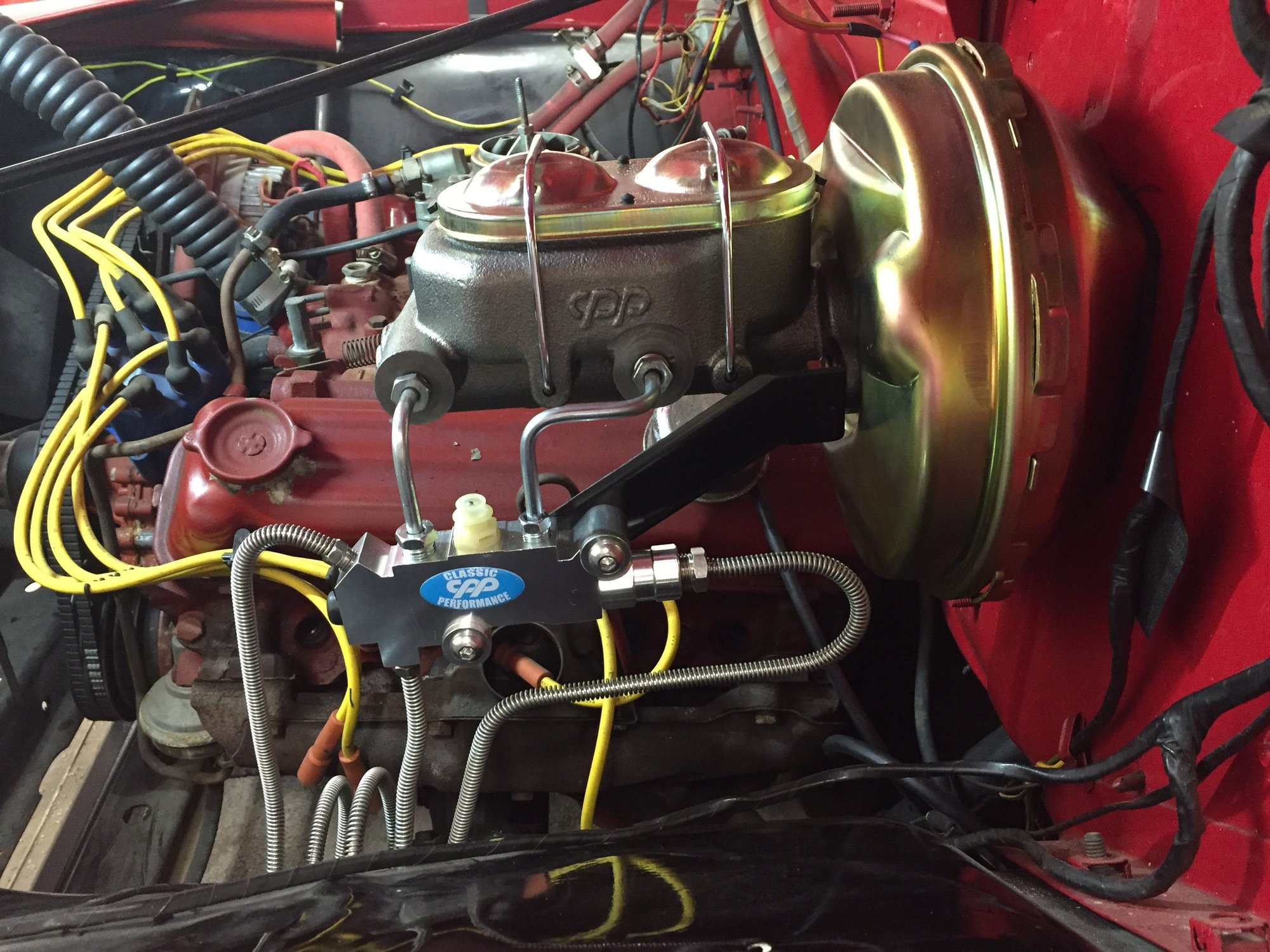

Here a few pictures of mine:

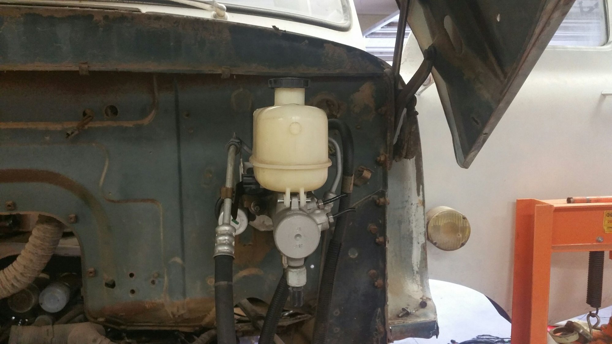

Used a Superduty hydroboost and an OBS brake pedal assembly inside on my '53 COE. Once I get the seats in and I am happy with the position of the steering wheel I'll fix the floor. I sandwiched a 1/8" plate between the booster and the pedals to strengthen the firewall. It will have braces welded to it to triangulate it and it should be plenty strong.
