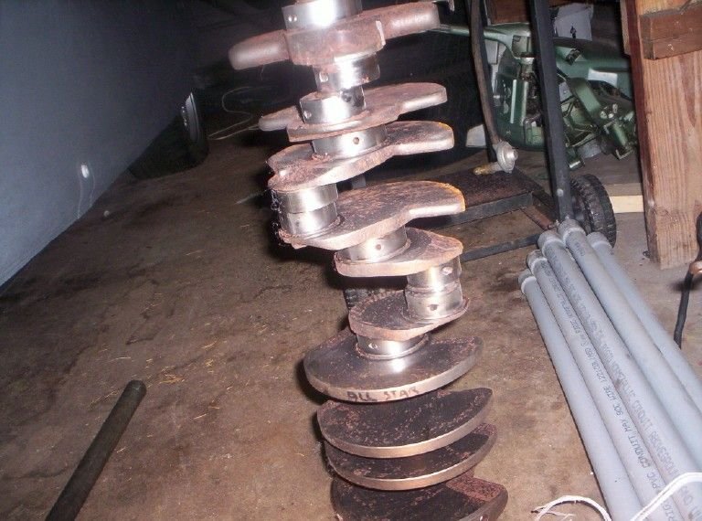

the biggest issue was production numbers, which was the simple answer, pouring protype money into items for the PSD's made more sense ,
real world the v10's did have a issue in how the crankshaft was made .rev them to far they would snap right in the middle of a rod area,
Old Aug 27, 2025 | 07:49 AM
manicmechanic007's Avatar
manicmechanic007
Joined: Jul 2020
Posts: 10,607
Likes: 2,683
From: Near Salt Lake City
That's the first thing we all saw at the dealer back when the V10's came out
Numerous broken crankshafts
Still like to have one but hotrodding one might be futile
That cast crank is damn thin in spots, and a forged one is not available
