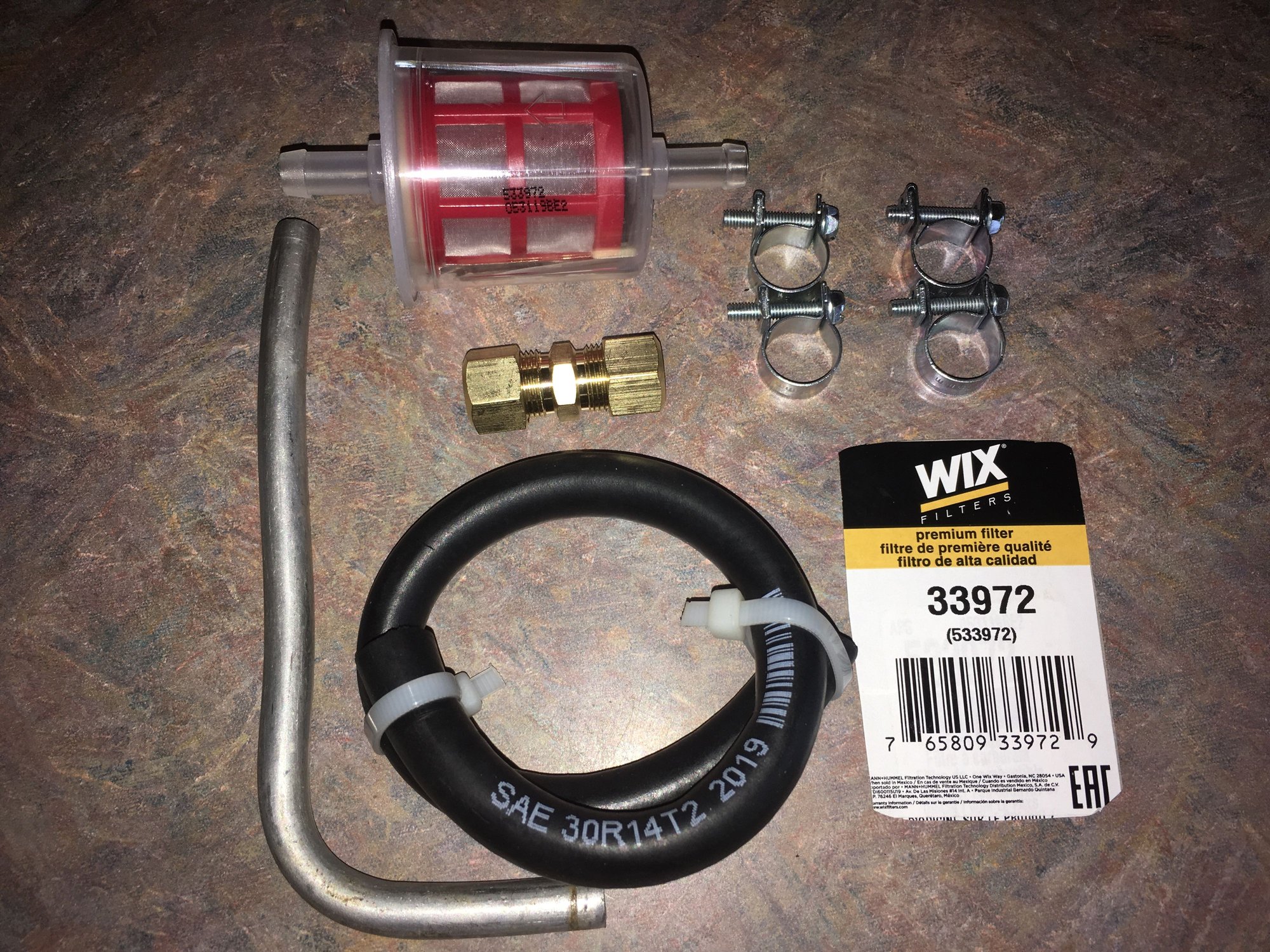

Ray, PM me an address and I’ll send you a peice of tubing for the in-tank mods.
Heres your parts list.
Old Sep 20, 2020 | 05:23 AM

Hutch and Harpoon mods complete!! Tank reinstalled, inline filter complete! (ThanksSSJ) I was completely surprised how much sticky goo came out of the mixing chamber! ANd I could see it packed inside the cartridges,
When I finished buttoning everything else up I took it for the required test drive. Wow I am completely surprised at how much of a difference it has made in how the truck drives. Definitely not like I expected for a 283,xxx mile truck. It quickly reminded me why I returned to the 7.3L world!!!
