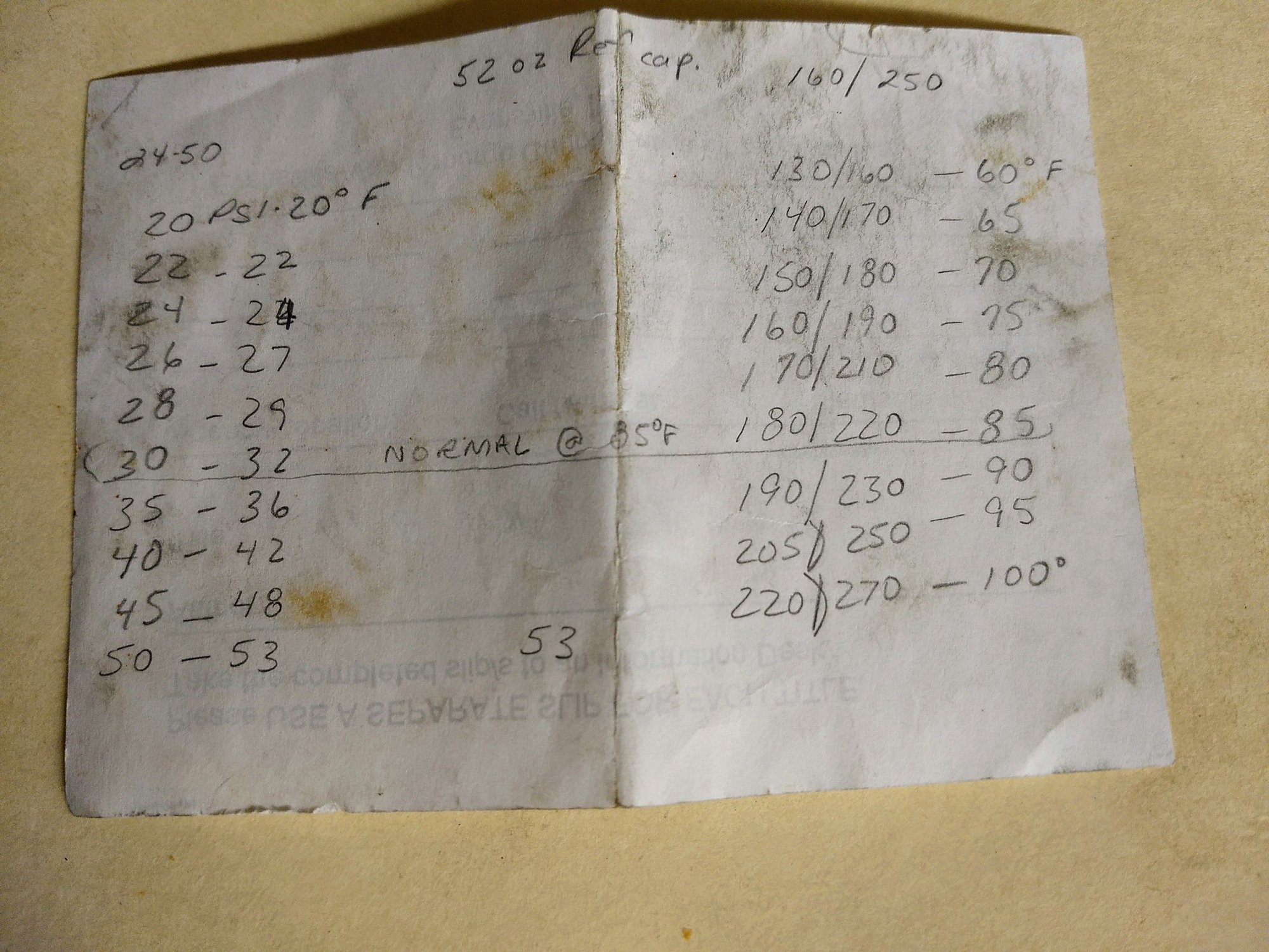

Granted this is for R-12. My cheat sheet I made back in the 80s when I first got my AC to work properly.
When the truck was brand new I took it to the dealership to complain about the compressor cycling constantly. They said that was normal, an energy saving function. BS. I went home and added some R-12 . It worked as I expected it to, for the next almost thirty years. Gave it a puff of R-12 occasionally, every few years. Always relied on the original sheet.

Originally Posted by diggerrigger
A quick look around the webs and it appears that a .067" tube is blue.
I guess you have a vacuum reservoir for the HVAC?
Well that's good it is the blue one, saves me some work.
Yes I do have one, it's a metal can I had to fix as it had rust pin holes causing a vacuum leak.
I do know the factory check valve was bad and now with the windows up I can feel & hear when it switches.
I will have to look at that cheat sheet when on me PC litter hard to see on my phone.
Thanks
