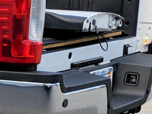

I bought my 2019 F-450 to carry a slide-in Truck Camper and I also needed a touch more height in the bed for the cabover of the camper to clear my clearance lights and Sat/GPS antenna on the cab. Everyone said "Just put a couple of horse stall mats in" - I bought a sheet of 3/4" PT Plywood and carriage bolted it down, then put in a DeeZee bed mat on top of that. I was already leery of the aluminum bed even though the bottom of the camper is flat!!! Anyway, those two things gave me the height I needed and some feeling of security for my bed floor! I originally just put two galvanized carriage bolts in the front of the bed (I figured it would allow more air flow under the plywood), but after about 6 months, the back corners of the plywood started to curl up from the heat of the black bed mat (just beginning here) - I had to bolt the rear down as well.
